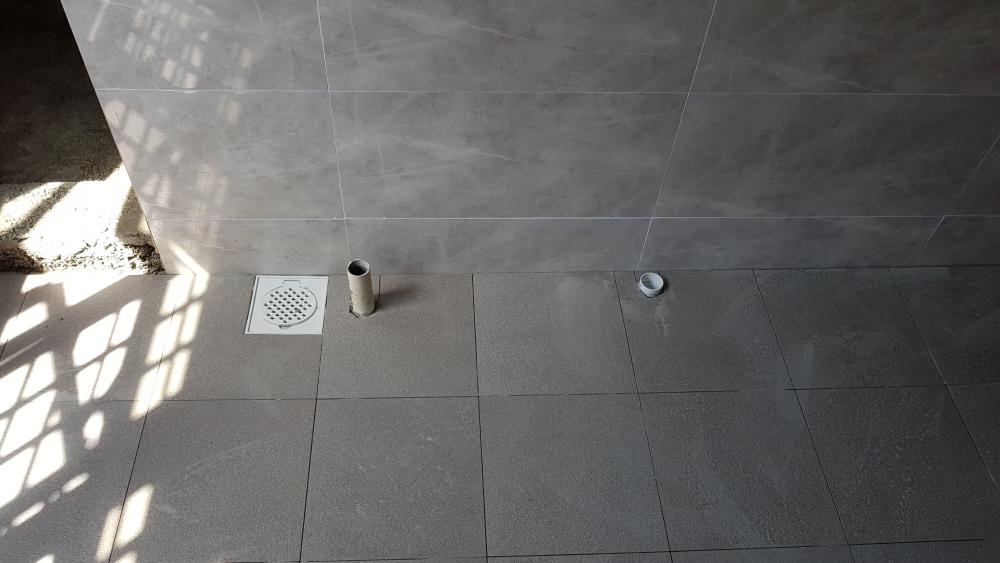

Has anyone come across HDB flat with no washing machine drainage pipe and need to drain out the water through the floor trap in toilet? Wondering if any plumbing work could be done to resolve this issue.
I viewed a resale flat and found this issue. Due to this issue, the washing machine has to be sited outside the toilet (in the kitchen) which is not ideal as it is hindering ppl from walking thru. Good if can have advice from folks here.
I'm currently doing reno for my resale flat. So since I'm hacking the kitchen floor tiles I ask then do to an outlet pipe for the washing machine. You just need to let your contractor or ID know u wanna do this.
