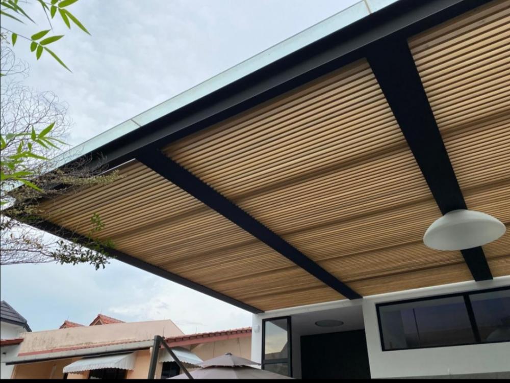

The heat penerated through the glass panel is no joke and especially worst as my orientation faces west, hence decided to add a teak trellis under it. It looks better than expected and more importantly it reduces the heat by at least 1 to 2 degree.
I wanted to do clear polycarbonate panel roofing for better lighting as well but my contractor warned me that it would get very hot so I switched to aluminium composite instead. Chose the thicker 6mm panels to reduce noise from rain hitting the panels

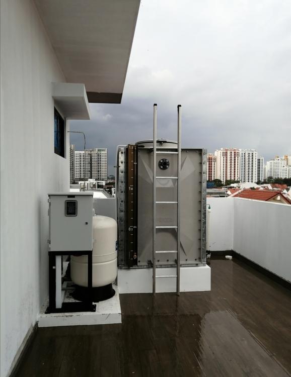

Hi, May I know why you need to put in a water tank? Also, could you please pm to me your builder? Thanks.
if any water fitting at the highest point in your house exceeds 25m in height (referenced from the Singapore height datum), you will require a water tank for your house as PUB water supply may not have enough pressure to reach beyond 25m height.
