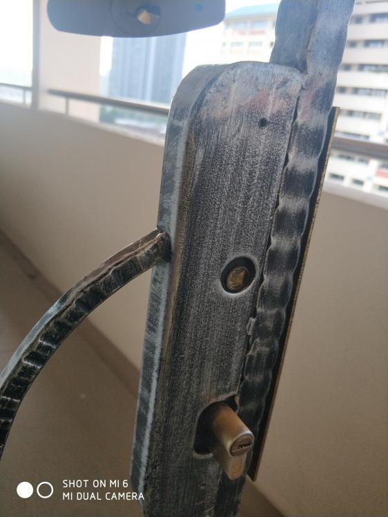

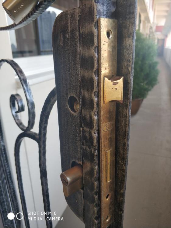

Hi I would like to ask you experts a question on how to remove the golden keyhole structure as shown in the pictures below please?
Basically the reason why im removing it is because the key can no longer fit in and we need to change the keyhole structure/key slot holder (unsure of what the exact name is)
I have removed all the screws already but the golden keyhole structure can't be removed sadly. The protrusion below is forming an obstruction. Need urgent help please. Much appreciated.
Thanks
the cylinder lock seems to be engaged partially hence preventing it from being slide out. you will need to find someway to use the key to turn the cylinder to the neutral position. else have to get a locksmith who can pick cylinder locks and have the cylinder turned back to the neutral position so you can slide it out. search online to see how the cylinder looks like and works and you will understand what i'm saying.
