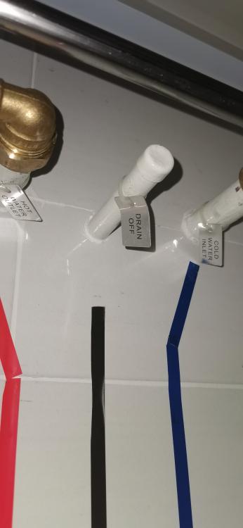

I would like to ask, did anyone with new BTO that have the drain off pipe between the hot and cold pipe for heater, use it for aircon condenser water instead? I wanna have less trunking in the toilet and that drain off pipe seems so redundant and not put in good use. It seems so much better since the pipe is conceal and it goes down all the way to the drain nicely. If anyone did any like this, please share with me.
what is the height of the drain off pipe from the ceiling?
an aircon wall mount unit is about 35cm to 40cm tall. so this means the aircon drain pipe will start at about 40cm from the ceiling (assuming the wall unit is installed all the way to the ceiling).
so if your water heater drain pipe is less than 50cm from the ceiling, then you can't use it as the aicon drain pipe as water flows down and not up. unless you install a water pump at your aircon to pump the condensation water upwards then you could use that water heater drain pipe.
If it is low enough, then should be able to use as to connect the water heater drainage just need another t-joint to do the connection.

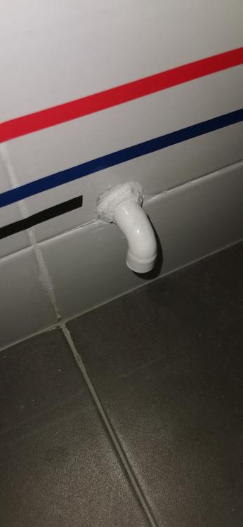

It's a new BTO so this pipe is actually at the top, with the water tank heater. Olden kind heater usually have 3 pipes but mine is the newer kind. Don't need this drain out pipe. The bottom part at the 2nd pic goes to the floor. Very near the drain in the toilet area.
