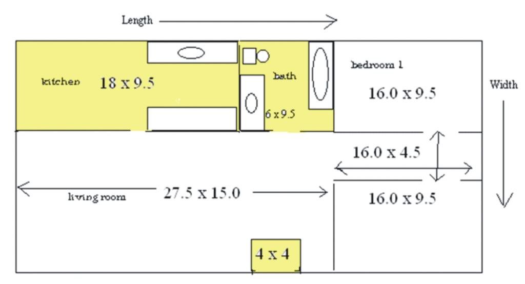

For Carpet, we need the square meter of the floor to be covered. If we have the floor plan, just look at the diagram, to get the square meter of the floor. (see the below example). and Add 10% to the total. This makes allowances for seams and other extra carpet needed to complete the job.
