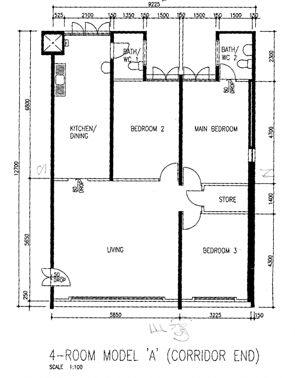

This was the first unit my parents bought as young adults, and housed my childhood memories. While nice, spacious, and sporting an awesome-sea view, its interior is also 31 years old. Timely for a revamp.

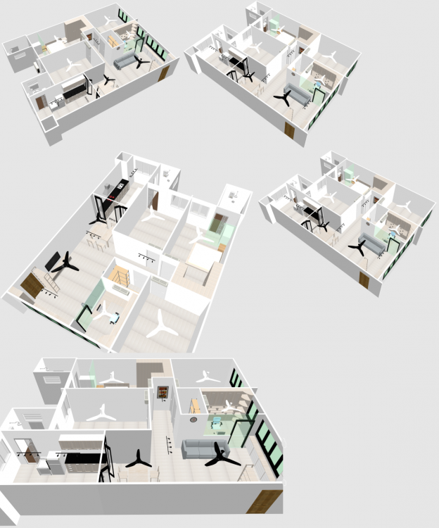

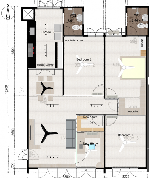

It will be a full revamp, and will involve portioning a section of the big living room for a study corner. The MBR will take-in the old existing store for wardrobe. The "true" kitchen will be made smaller, and a freshly-designated dining area will be made more spacious with the hacking of 1 segment of the wall. Two rooms will be left unmodified, in case my family expands then I might consider swapping HDBs with my folks.
I did a preliminary mock-up in sweethome3D.

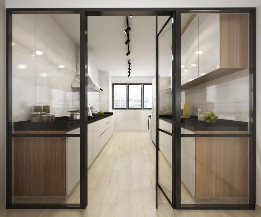

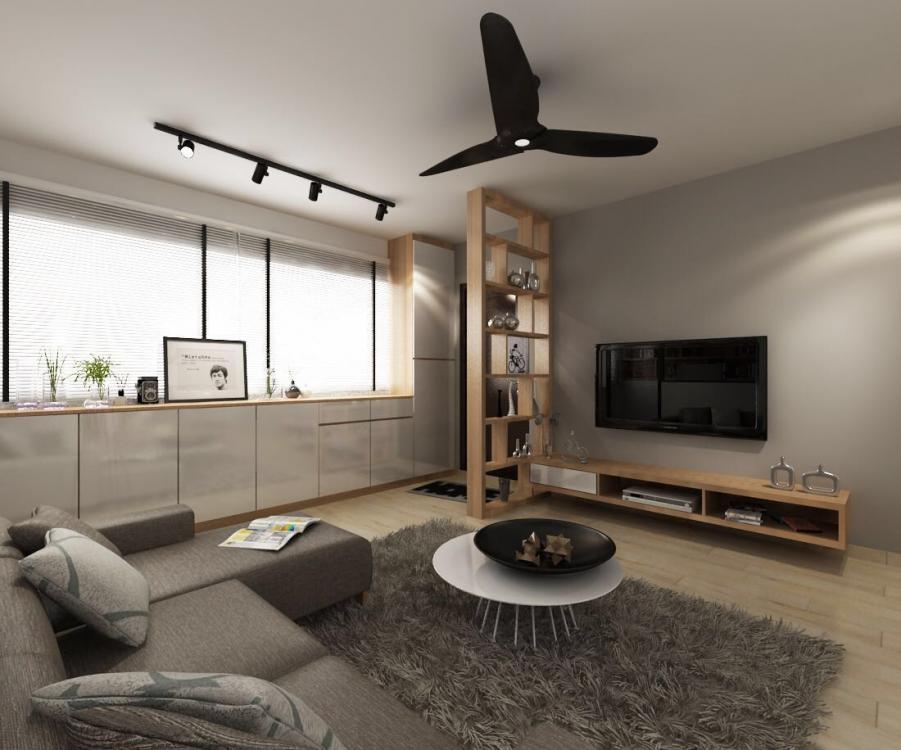

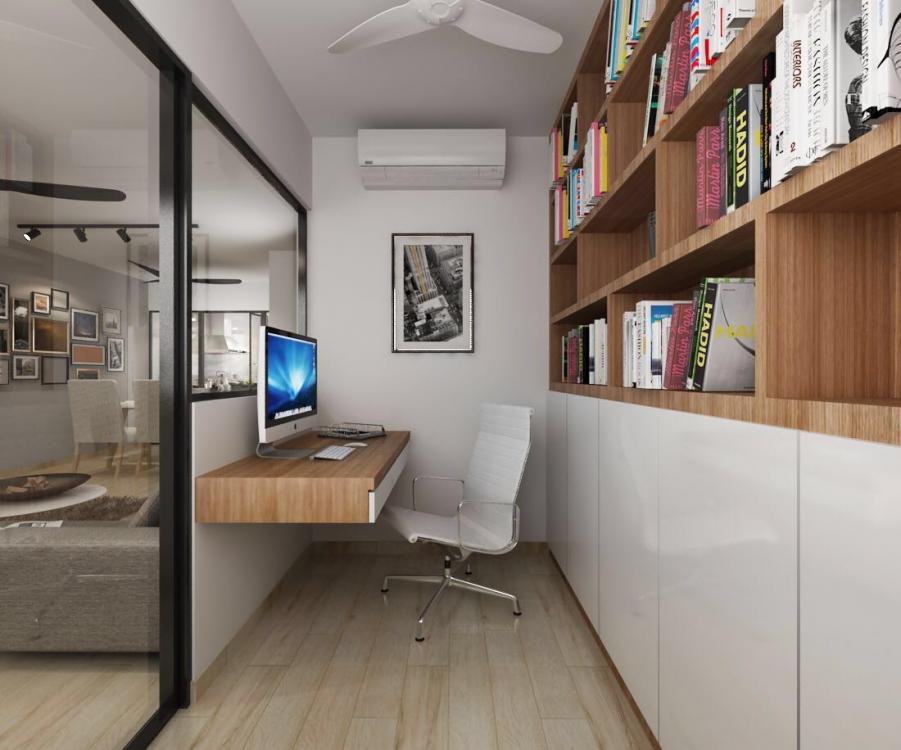

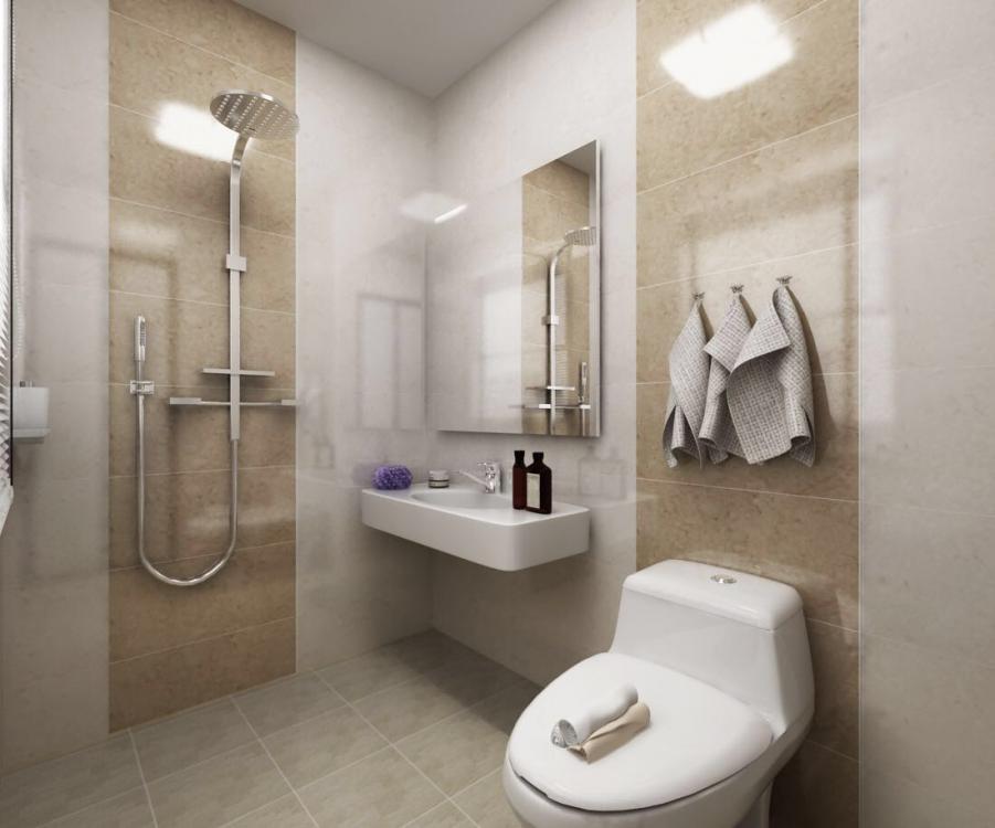

In seeking quotations, I provided some visual references for the contractors to agar-agar know what I wanted:
and spelt out clearly what I wanted:
  • Quotation to include lights, sinks, toilet items and built electrical items (eg fan and aircon)
  • Floor tiles to be replaced, walls to be re-plastered and repainted, piping and electrical conduit to be redone totally
  • Hacking and erection of new walls. Existing windows and window grilles to be disposed, and no grilles thereafter
  • Kitchen to be resized, and the drop for the kitchen is to be delayed further North, and done through a slope across a 50cm ramp down
  • Strong emphasis on practicality eg: no L-box ( to prevent insect/pest droppings) all flooring to be tiles (can be cheaper Chinese tiles if need be), track lights (for easy replacement of spoiled LED lights), ceiling fans (DC ones with LED room lighting), 2 individual electrical water heater (the unit does not have piped gas), all carpentry to be suspended for easy of cleaning, else built on raised cement/tile platforms (eg wardrobe / MBR bed). Will go for full induction cook hob to avoid needing LPG canister.

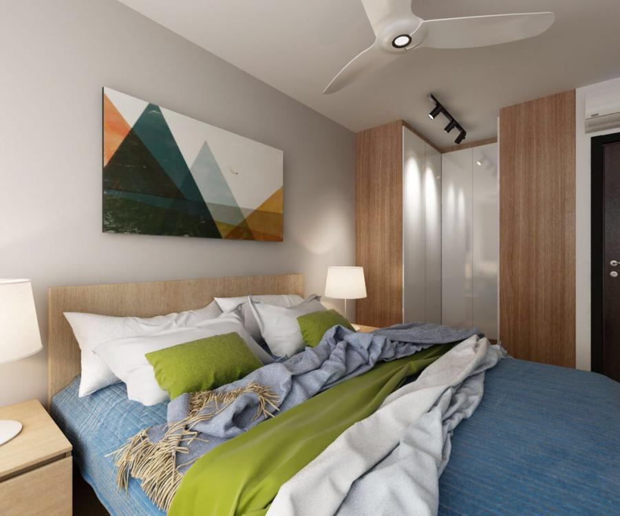

Brought my folks down to SBH to select tiles and laminates and the contractor generated the 3D drawings. Hacking starts tomorrow!

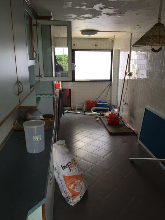

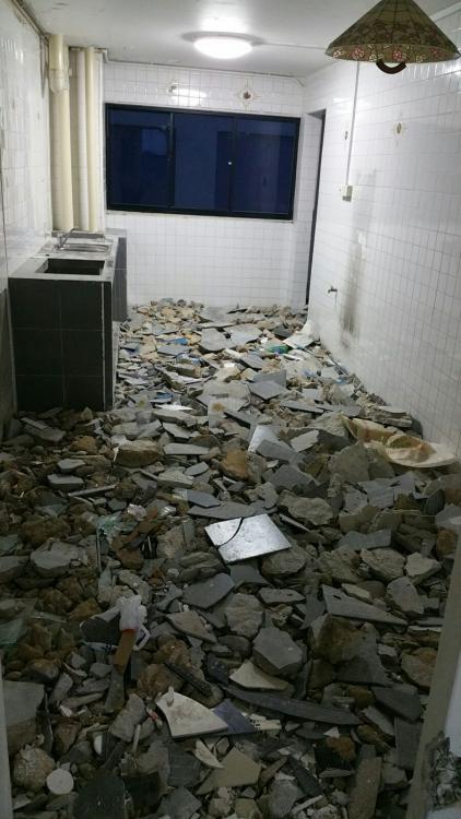

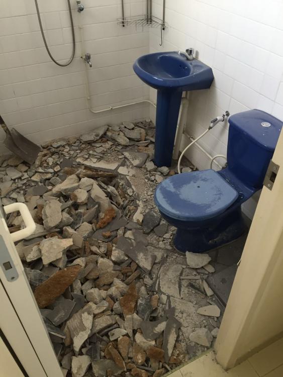

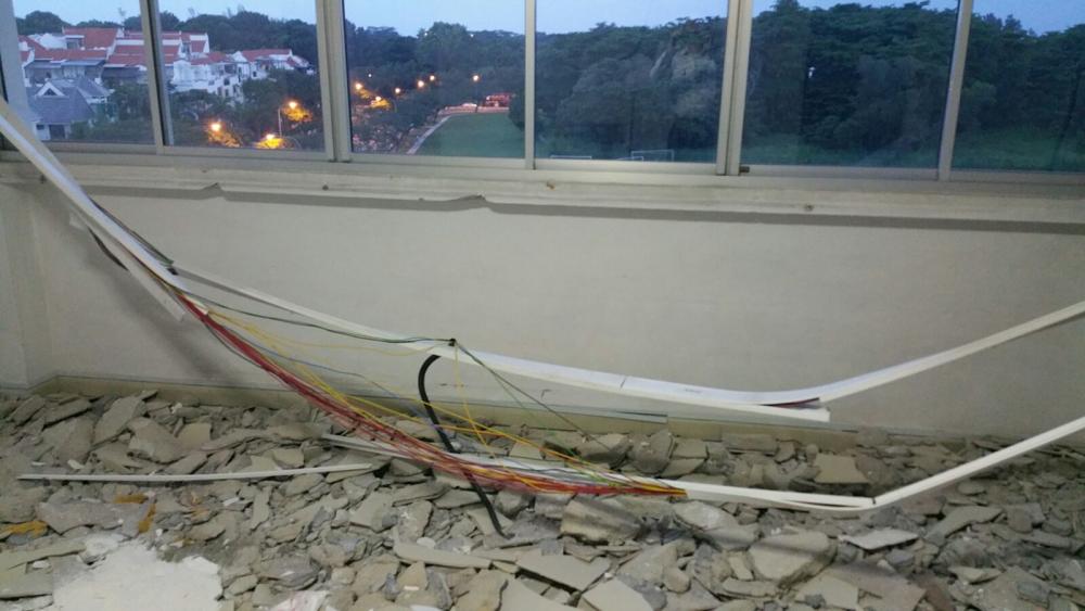

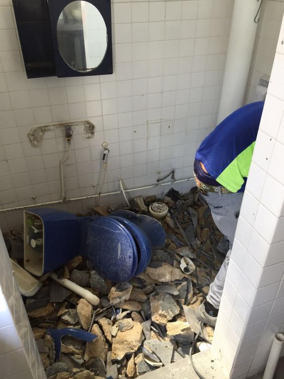

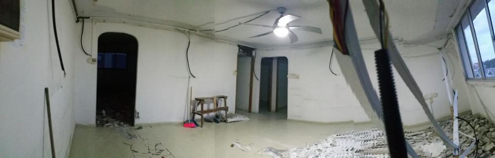

my folks spent a good week or so packing up their stuff and when that, its time to let loose!
