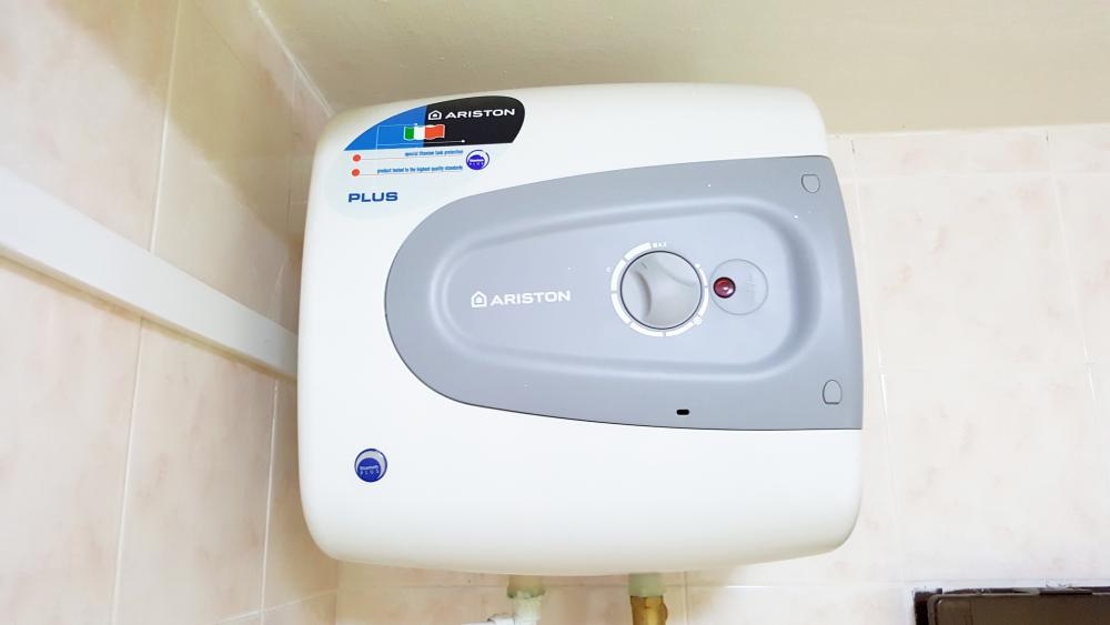

Hi,
1. I am using this Ariston (Plus 15 or 1.5 sin) storage type water heater left over by the previous HDB owner in my master bath at the moment. I found that this water heater has a hot water outlet and a cold water inlet (with a safety valve connected to the cold water inlet). I used to have a Rheem water heater and it has a safety valve seperated from the inlet. I also googled and found most other Ariston water heaters come with seperate safety valves. So I am a bit doubtful that this safety valve works well. Any advice ?

If it is not too late on your questions...
I am currently using the Ariston (same model as yours). Install it 4 years back (DIY) to replace my earlier unit (also Ariston) that started leaking. Don't worry. The valve is installed correctly thou' when I bought it, the valve was separated too. Inside the heater, the cold water pipe ends higher while the hot water pipe ends lower. If there is an over pressure in the storage tank, the pressure/steam after the water level in the storage tank will push back outwards thru the water inlet pipe and out the relief valve.
