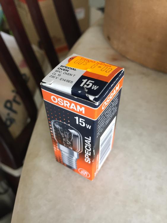

Just resolved this myself. So if you need a replacement, just head to your hardware shop which sells bulbs.
You need a heat resistant bulb. I got myself an Osram bulb made in China. The original lasted 24 years! and was made in Europe.
It was useful that Osram actually indicated "Oven" on its packaging. Do note there are non-heat resistant types at 15w meant for Fridge and Freezers. Do also note the W and V rating for your original bulbs.
Just $8 and the dealer was going to charge me 12 and was located in an industrial park.
