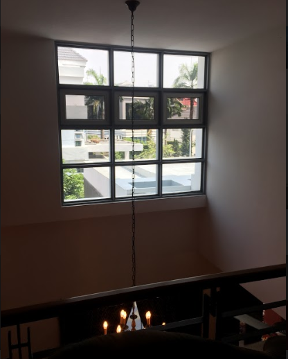

This is the window at our high ceiling. (Its a north facing home - so it gets hot quite easily) s we decided to to install auto roller blinds here.

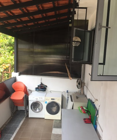

Yard

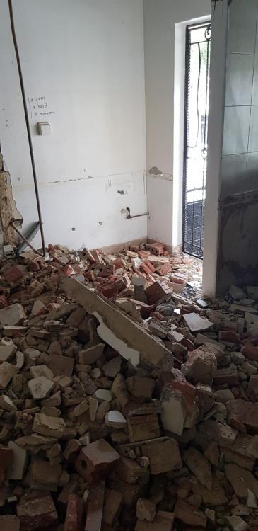

Kitchen -hacked a wall to make it bigger!

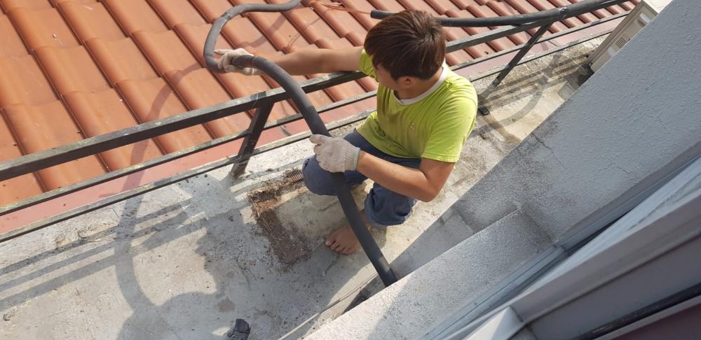

Wah, didn't think we will need to do this. But after some checking - best to get this done! cost us a bit but no choice.
getting reading to put the medicine for the termites.

your house has the ideal north-south facing which would not get the morning of afternoon sun. so not sure why you want to install roller blinds on the windows which are facing north.

Our house facing North South - yes its the ideal direction. But after going there many times after we collected our keys, we felt it was still hot so we felt just install the roller blinds there so that we have the provision to use it when we would like to.
getting it from our curtains/blinds contact that did our previous homes- pretty decent price for Sompo blinds.

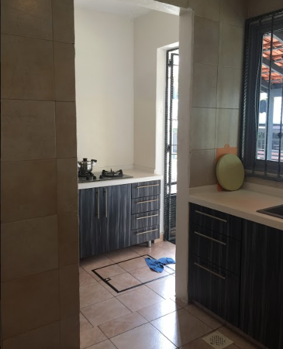

Just had a meeting with our carpenter to discuss the ideas for all the carpentry. Sigh, every time there will be some new thing that crops up.
So for our kitchen cabinet - since the depth is 620mm there will be an issue as the wall beside it is 600mm. Ideally we should extend the wall so that the carpentry will be flushed with the wall. BUT should we decide to do that, than we got to hack the other side of the wall  and then we got to make some changes to the steps at the yard. :bangwall:so much extra work which means :~ more cost involved.
aiyah, such a headache. this is for the wet kitchen which is connected to the yard wall. so the hubby feels its ok, not a big issue as it will only be visible that its not flushed at the yard side - which really no one would really notice. tomorrow we will have another round of discussion. hoping we can resolve it.

I would suggest you keep your kitchen cabinet at 600mm rather than 620mm. I was told that contractors will do costing for cabinets based on multiples of 300 or 600mm. anything outside this "standard" multiples will cost slightly more due to more material wastage. this is because the standard plywood sheets comes in sizes of just slightly bigger than this 600mm multiple.
for example, the plywood sheet is 2400mm x 1220mm. so if your cabinet is 600mm, the carpenters can cut 4 pieces of 600mm x 1200mm out of the sheet. but if your width is 620mm, they can only cut 3 pieces of 620mm x 1200mm out of that sheet. of cos that last bit of about 550mm x 1220mm still can be used for other things but wastage is higher since the dimensions of left over is odd sized already.
hence it would be better to adjust your cabinet size rather than hack the wall to cater for a slightly deeper cabinet. After all, how much gains can you get from the extra 20mm of space?
Hi Snoozee!
Wow, thank you so much for your post. I will take note of this information.

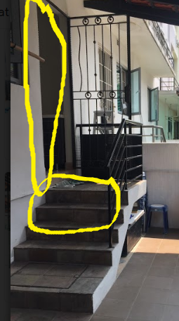

Wah, after your post, i went to check the old photos (prior to hacking) and realize that the old carpentry was sticking out too. it was 620mm but that wall there is 600mm. actually it seems ok to leave it like that.
The carpenter suggestion was to extend the wall to 620mm. which means that the yellow parts had to be hacked to fix the whole thing. If we keep it as status quo - then it will look ugly as it is not flushed so its whether we are willing to accept it that way.
lets say we just extend the wall to 620mm (so that the cabinet is flushed with the wall) but dont hack the yellow parts - then the gate (we are removing the existing one) will become smaller. which i think is ok, isnt it?:dunno:

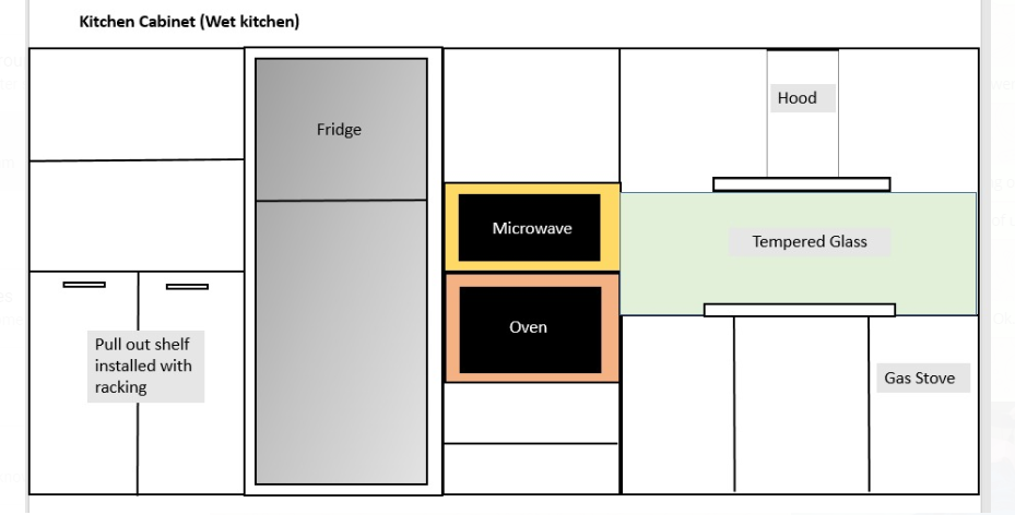

also must check the dimension of our oven - cos we are building in on this side of the wall. Below is the design for this entire wall. if oven is 620mm then no choice must stick to that.

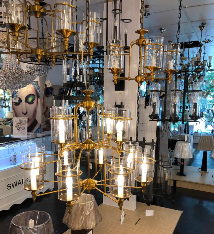

Lights, lights and LIGHTS!!
That is the BIG decision now we have to make with regards to our choice of lights for the foyer and living area.
Ideally we would like to buy two similar lights (one big & one smaller) so that the entire area will look nice and in sync.
These are our choices so far:
Choice 1 ---- Lighting Centre:
We saw these! really nice! they has 3 sizes. so we thought take the huge and medium ones. It is brass - so it will last really well. in terms of how design - its pretty nice. But really expensive - it will cost us about $2500 for two of these (one huge & 1 medium).
Choice 2 ------ Chan Huat
 this one - the huge version has 24 bulbs!
and the smaller version - realize this picture is the small size. we r looking at the medium one which is slightly bigger.
These two cost $2400.
I prefer Choice 2. but we r really seeing if we can find something else - which wont cost us above $2000.
oh my! such a tough time searching for the perfect lights!

oven need less than 600mm of depth. search on google on the oven model you want and check out the dimensions.
Yes, indeed. just checked the model specs we bought. its less than 600mm. :)
