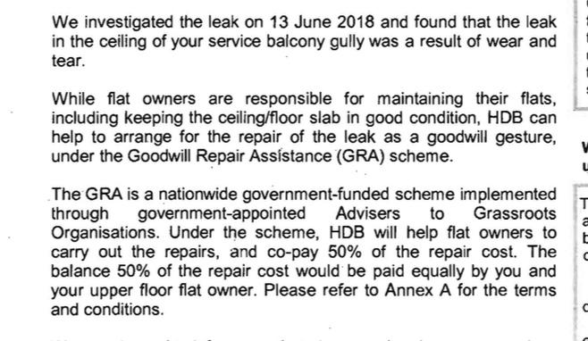

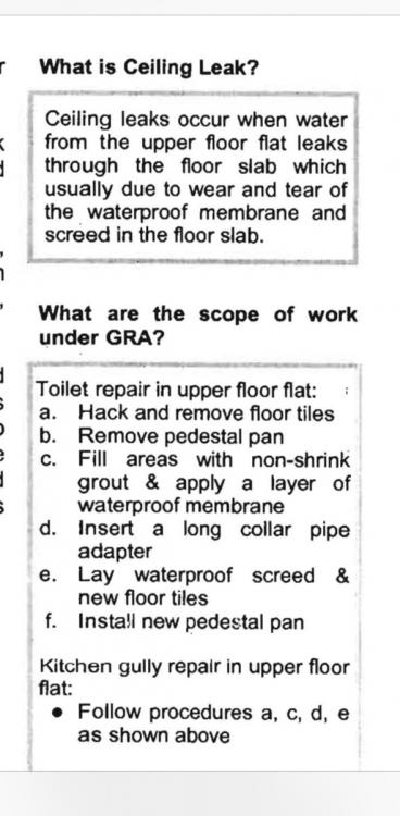

  9. Okay, this was what happened yesterday...
    I thought the sanitary pipe leaks again. Called Town Council, the same plumber came.
    He touched the ceiling and showed me his palm. It was wet! He then told me to on all the lights. He started pointing on the ceiling. That’s when I realised there’s water mark stains.... and some on the kitchen!
    So this morning, the HDB officer called to update that he had checked the above unit. He mentioned something about their washing machine pipe.
    So since its connected to my pipe, I will need to pay $150 max. HDB 50%, another 50% split between both party.
    The above unit also has agreed to hack off their two toilet. This I do not need to fork out any cent. But they want the work to start only after hari raya. And hari raya is ONE MONTH! So I requested if they can have their pipe fix first on a weekday.
    Hoping they’re okay with that, don’t tell me there will be guest coming everyday
  10. Plumber came to rectify the crack. Was informed this normally happen due to wear and tear of an old hdb flat.
    Plumber also informed me that he suspect above unit is leaking. So i told him to look at the ceiling outside the toilet window panels. Then he went like, “Aiyoh! Confirm upstair leak. Call hdb faster faster.”
    I’ve already called and emailed hdb but still no follow up. It’s been a month plus. Keep telling me someone will arrange for an appoinment. Kind of frustrating.
    So plumber told me he will help to get Town Council to call the hdb officer in charge directly. And voila! One hour later, someone from hdb called!
    Hdb officer came down in the afternoon. Did a test on service yard, kitchen and toilets ceiling and confirmed upstair unit is leaking. Sigh!
