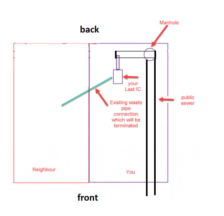

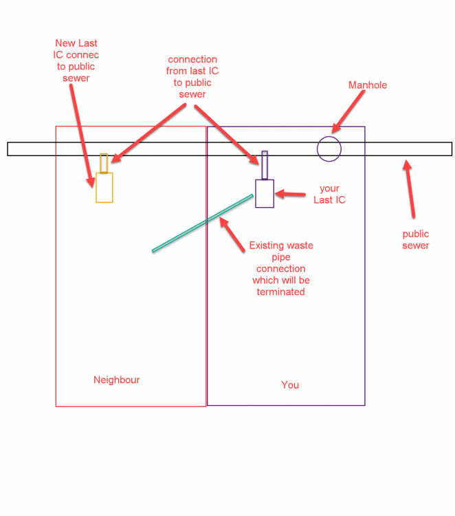

If you look at my drawing below, what could be the case is simply the contractor needs to open your manhole to do a pre-con CCTV survey now (and later a post-con CCTV survey). After their last IC is constructed, connected to the public sewer (NOT within your land) , your last IC will then need to be opened up so that the existing connection from the neighbour side to your last IC is terminated properly by pouring in concrete, etc to fill up the pipe.
Again, IF you do not have tiles or any flooring sealing up the last IC and manhole in your house, there's NO need for the contractor to hack your floor at all to do their job.
Before you jump into a fit and think of what you can demand on the contractor to fix your house, I would suggest you talk to the contractor and find out exactly what they need to do within your property. As I've mentioned, you have every right to deny them access to your house. The contractor will just have to find the next manhole to access to perform their CCTV survey and not bother you at all. However, as mentioned, if the termination is not done on your side, you may or may not be liable for your neighbour's property damage should the termination fail in future and your waste flows over to their side.

Unfortunately the public sewer does run through my property as shown in my drawing below. So in event of a complete rebuilt my neighbor contractor will need to connect to the public sewer via the public land in front of my house. Otherwise, if he wants to connect the public sewer via my manhole then hacking of my backyard will need to be done.
Do note that both my neighbor and my house share the same last IC, which is located in my house backyard. There is only ONE waste pipe from my neighbor to this IC, which is then connected to the public sewer.

As mentioned, you can deny them access. If I'm in your situation, I would not grant them access to hack my floor to do their sewer connection as well. However, since the existing sewer connection needs to be terminated properly, you have to grant them limited access to do this. Whether you want to let them open your manhole to perform CCTV survey is up to you.
Your neighbour's new IC can be constructed in their driveway and then connect to the main sewer which is running through the public road/land.  How they can do it is another question as a sewer connection should be direct so it could be challenging. Anyway, doing the connection outside is the only way they can do it since they can't touch your property at all. Of cos they will need to submit the plans to PUB for approval first. With regards to sealing of the existing connection, there's some standard procedures from PUB on how it should be done.
If I were you, I would request for a method statement from the contractor and signed by a QP on how they are going to do the sealing. This is just to protect yourself in case something happens in future with the termination point. As the termination will actually be done inside the IC, any hacking (if needed) will be done inside the IC. I'm not sure if any hacking inside the IC will be done but there could be some minor hacking to roughen the surface of the IC so the cement could adhere properly. The exact details on how the sealing will be done should be described in the method statement from the contractor/QP.
