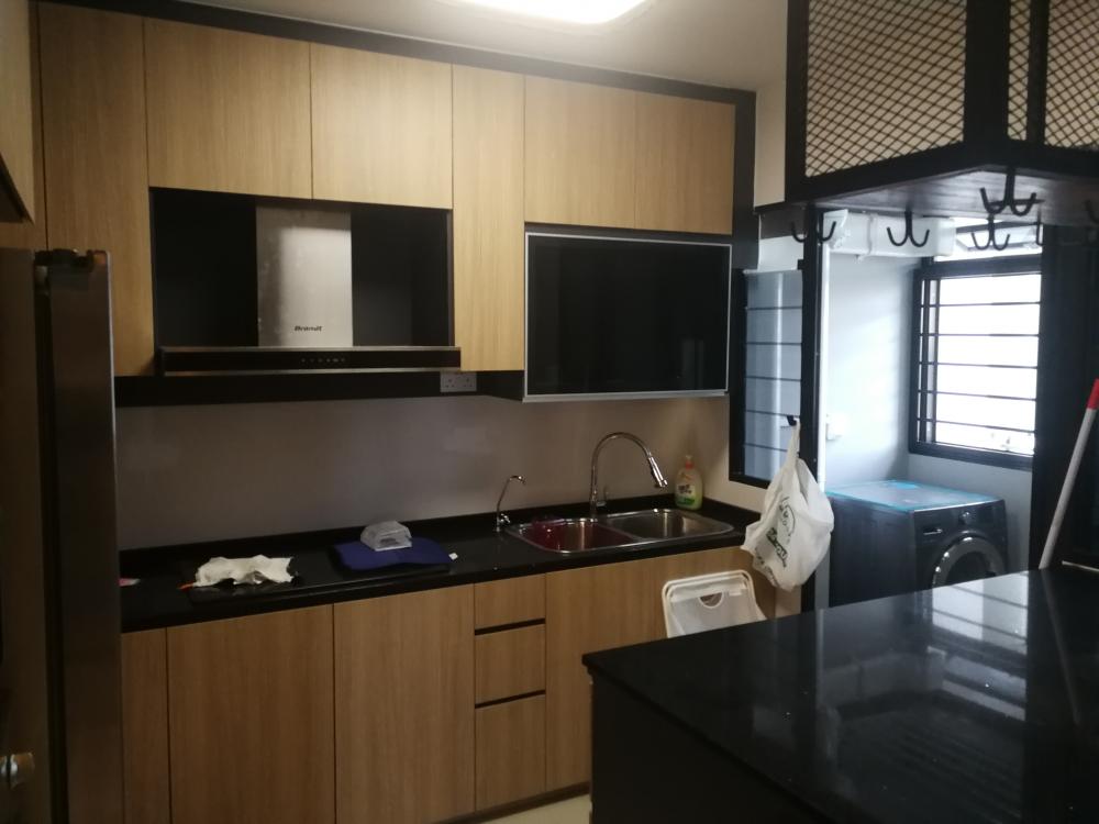

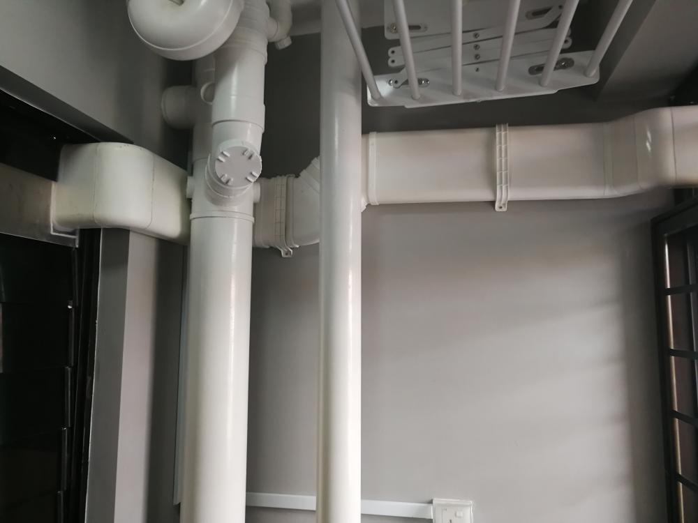

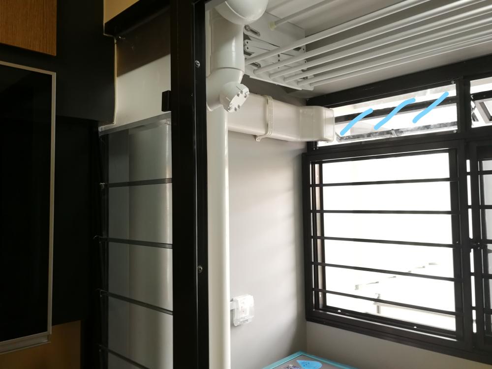

We were established in 2017, we specialise in kitchen hood ducting system for residential in Singapore. We had also sought HDB consent and they had confirmed we DO NOT NEED their permission to build our ducting system. But we are to ensure that Charcoal(remove odour) and grease filtration of the output must be sufficiently done and certain area must also be taken into consideration to prevent causing any unhappiness to our neighbours.
We had summited our lab grease output to HDB, through our experiments. Conclusion: Using this system is far more effective than none as most grease that passed through filtration is trapped on the grease filter (97+ percent). Smell of Fume that passes through Charcoal filter (active carbon) will also significantly reduce as compare to using none.
We had also summited heath research reports done by very well established organisations that strongly suggests that inhaling cooking fume could lead to respiratory health issues like Lung Cancer, Asthma …ETC
Cooking with a hood that is ducted out is really the way, In Europe, US, China and so many countries to name were doing this but surprisingly we Singaporean are not! Most folks do not know we can use filtrations and of course “kia COMPLAINS”?
WE DESERVES a well ventilated kitchen!!
Attached are some of the works we had done so far and we have so far got 100% positive testimony and feedbacks by our customers using ducted out hoods system. Link to our FB page below and our contact number
