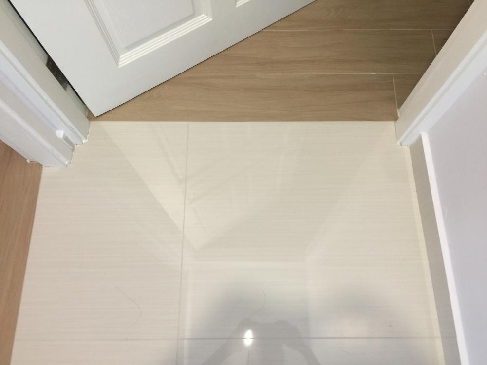

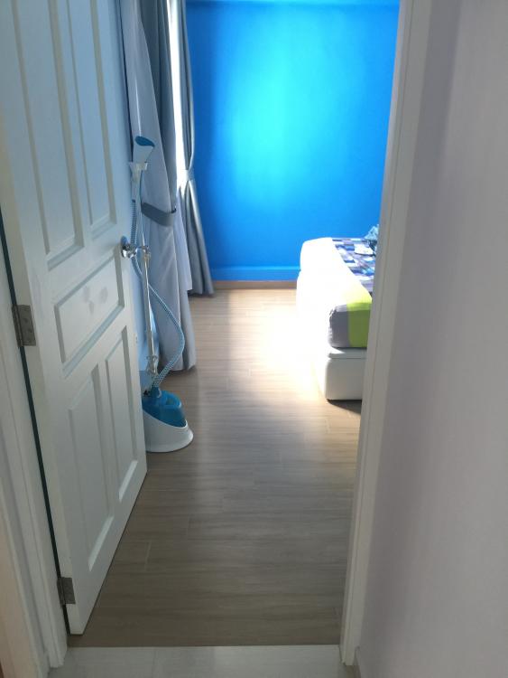

Recently, I have completed my renovation and moved in to my new house. However, we noticed that the tiles in the master bedroom seems to be off alinement. It seems like the tiler took alinement for the newly reconstructed door entrance which is not straight ( the left of the door frame is 1/2" more then the right into the room ) as a result the tiles in the whole room are slanted to the right. Is this standard acceptable and is it reasonable to get my ID to redo the tiling work? Im a find time owner and is seeking your experience advise on this matter and i hope the photos below will help you better understand the situation.
Updates:  ID will be coming up with a rectification plan and schedule next week. Keep my finger cross
1) The Door entrance is relocated and reconstructed

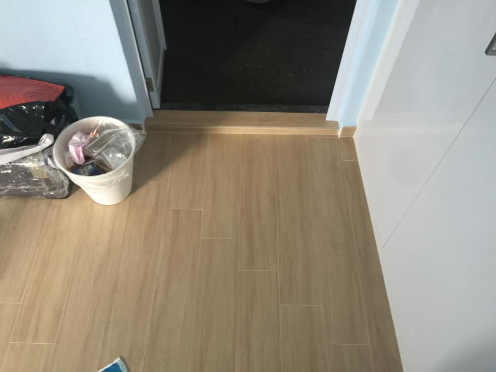

2) Towards the end of the room the misalignment seems very obvious

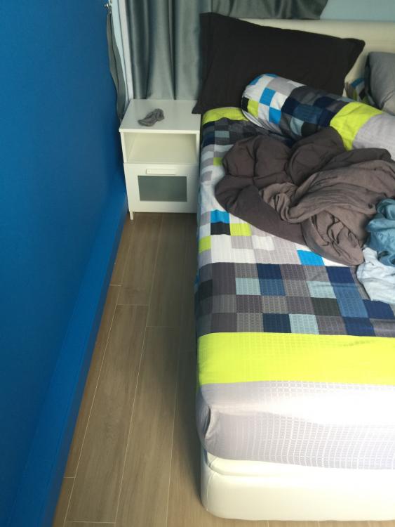

3) Another view of the tiling in the room

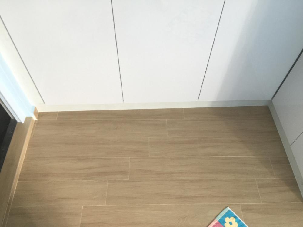

4) View of the toilet kerb and cabinet
5) Tiling outside toilet entrance

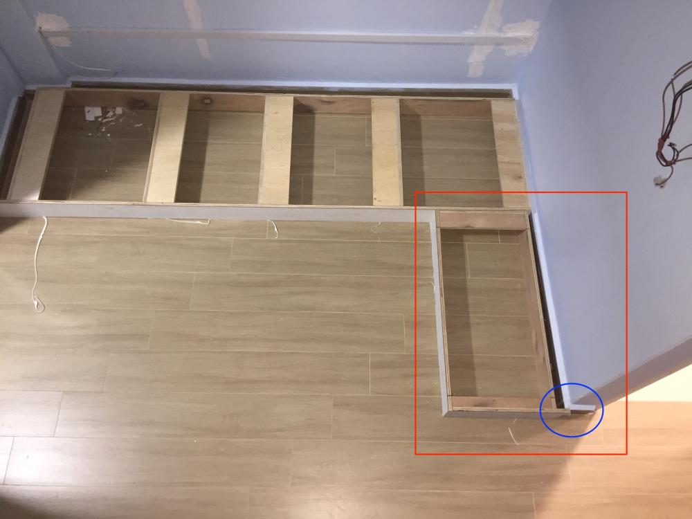

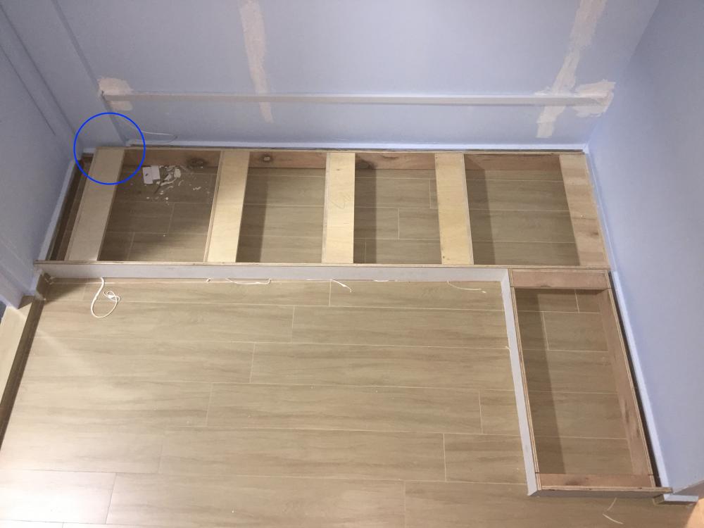

Rectification Work Stage 1 - (Dismantle and reinstallation of Cabinet)
Root Cause of Slanted Cabinet - (Base on my own understanding and explanation)
Original Cabinet Base Position - Focus on the red box and clearly we understood that the carpenter forgotten to offset for the protruding wall on the left and proceeded with the installation. Resulting in a slanted cabinet installation.IMG_8547.JPG.5b77978a28ae0ed548bcf0f266a1ef7b.JPG
This is how the cabinet should be installed - ( Base on my measurement of the depth and width of the cabinet as its already dismantled)
However in order to straighten the cabinet, the short side of this L cabinet will be protruding out of the wall(see blue circle)

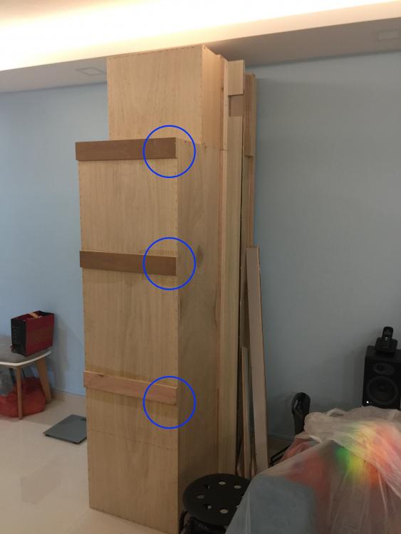

I guess it is still possible to straighten this cabinet without a redo
The cabinet base will have to first seat all the way in touching the skirting (see blue circle) and the back support of the cabinet (see 3 blue circles)will have to be trim off ~1inch to compensate for the protruding wall.

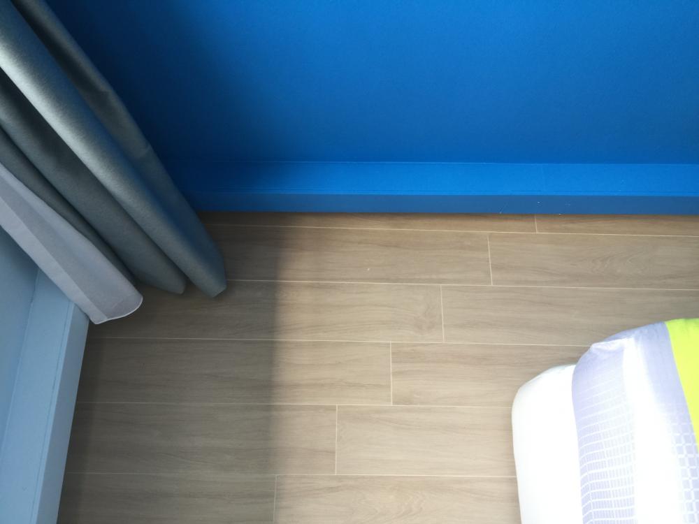

Many thanks for your input, maybe the pictures does not bring out the overall layout of the room properly. Base on picture 2, theres a 4cm slant between the first tile on the left wall and the last tile on the right and this applies to all tiles in the room. In general, the tiles are all slanted by 1cm each as the alinement is taken from a slanted door entrance which they reconstructed.
The bedroom door was tilted for feng shui reasons? You have to ask yourself, will the tiles look more weird if they had used the old door position for alignment such that when you close the bedroom door you actually see 2 tpye of tiles?
Being thru 3 reno projects and gng thru a 4th now....i pretty much understand how tilers work. The first tile they lay will be at the main door entrance...and every tile will take its alignment frm that tile. If the bedrooms are using the same type of tile as the living, most of the time they continue on. If its a different type then they will end the tile at the bedroom entrance and lay the diff tile at the bedroom entrance in the most central position....and every tile will use that tile as a guage.
For your case the slant looks obvious partly because the tiles choosen were long strip type. If they were the squarish 60x 60 tiles, dont think you wld be able to tell there is a slant at the wall with a naked eye
Maybe ID shld hav advised you to use the same type of tiles and continued on frm living room.
To redo the tiles, you wld hav to hack away since overlay is out cos the bedroom tiles wld end up higher than living....that means you wld have to hack away the wardrobe as well....not to mention the aircon trunking that is so close to the floor.
Feng shui is suppose to make our lives happier and not add trouble....maybe try not to focus on the slant at the walls and instead think of all the good energy coming thru that door.
Thanks fingerscross your past reno experiences sure is going to be helpful. The bedroom door is not tilted for any feng shui reason or purpose and i thought it should be straight by default and didn't pay attention to it and let my ID handle everything.
Agree the tilers started and use the main entrance for the living room alinement but upon finishing the last 2 60 x 60 tiles just out the master bedroom door entrance constructed by them as seems in the picture. The tile should have also notice the door frame is slanted as he has to cut the living room tiles slanted in order to fit. The living room tile on the left is 1.5cm - 2cm longer then the right.
As a result the tiles are slanted in the master bedroom as the alinement was taken from a slanted door entrance.
