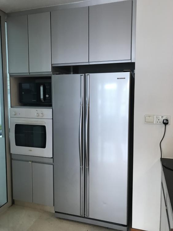

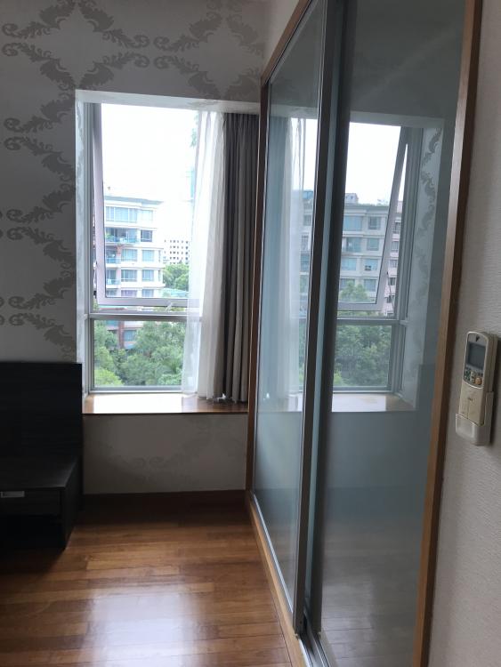

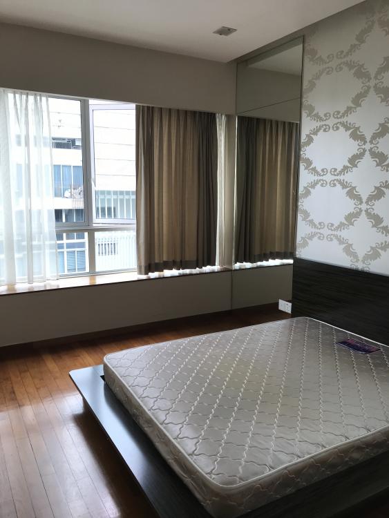

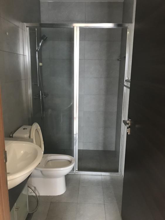

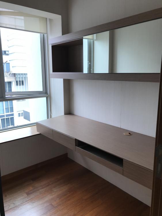

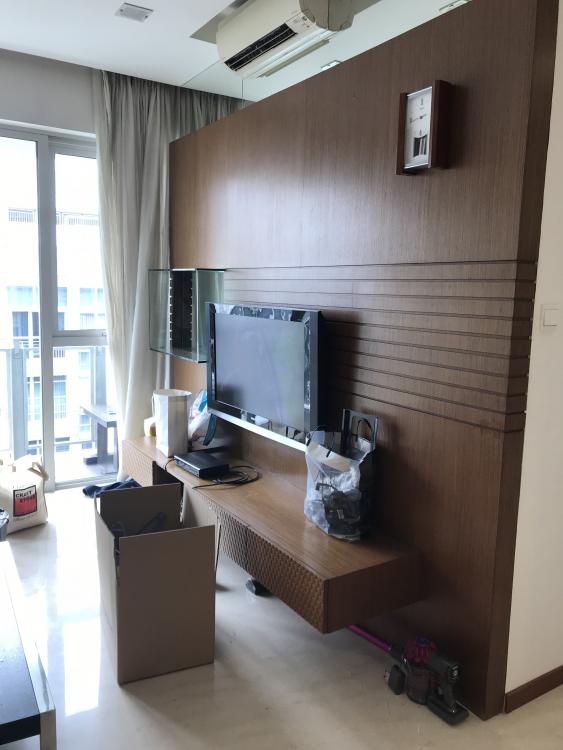

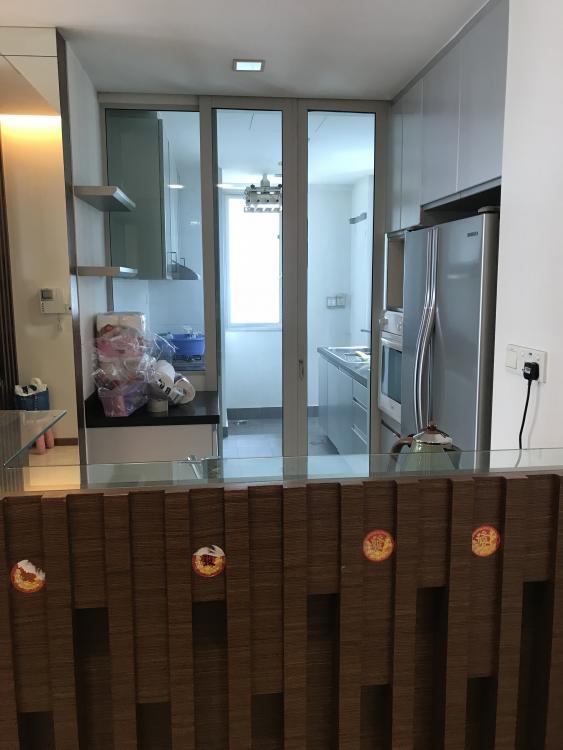

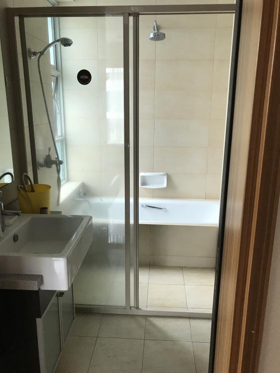

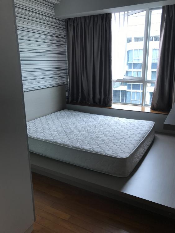

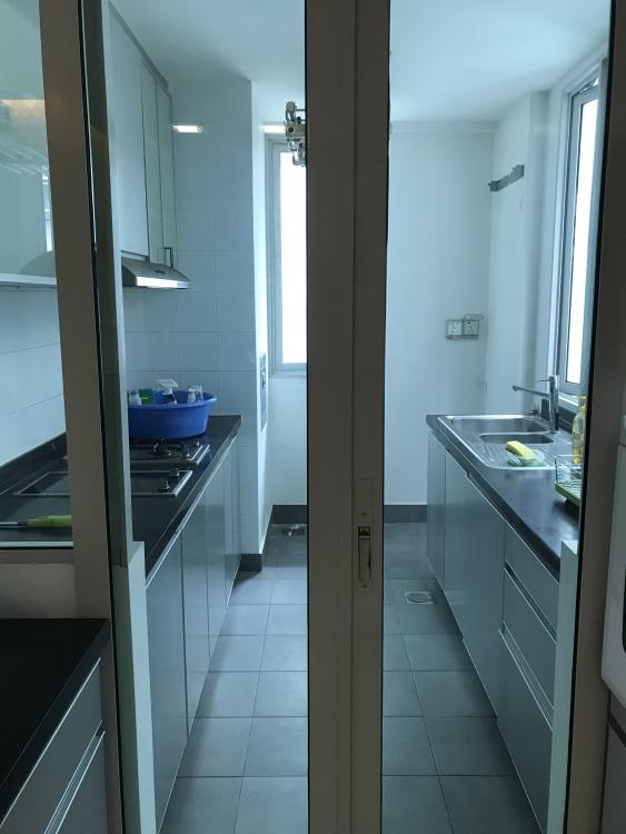

Our place is a 2+s unit, around 1000sqf. Pictures of the the old unit before reno commenced. The old unit had a lot of darker color wood built in and platform beds which I personally dislike.
Some pictures!

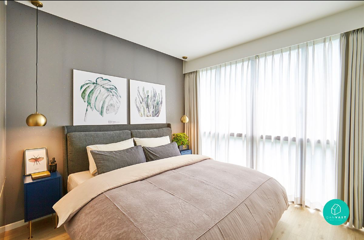

I was lucky the hub allowed me pretty much free rein in designing the house :D I thought for a first house I would like a scandi/ minimalist kind of design in the house with lots of space for the kid and perhaps a pet (in the near future?) to run around and play.
I wanted to go home to an apartment filled with light woody colors complementing some marble prints and lots of white spaces/ furniture. We were lucky our place was on a higher floor so there was lots of natural light flowing into the house in the day.
I had to turn to the www and Pintrest, Propertyguru, Quanvast and dayre were my best friend for design inspiration as I didn't really have the energy to run around in the first trimester. Snooze was my best friend then.

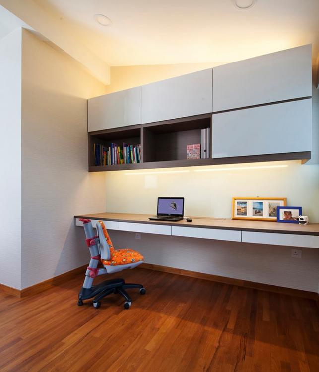

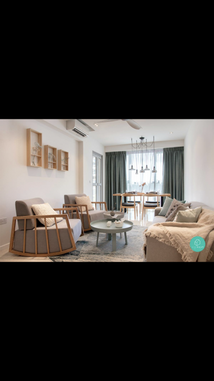

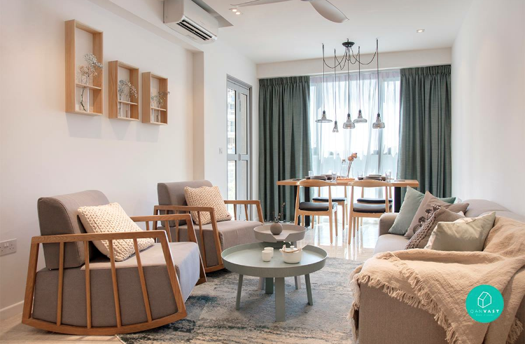

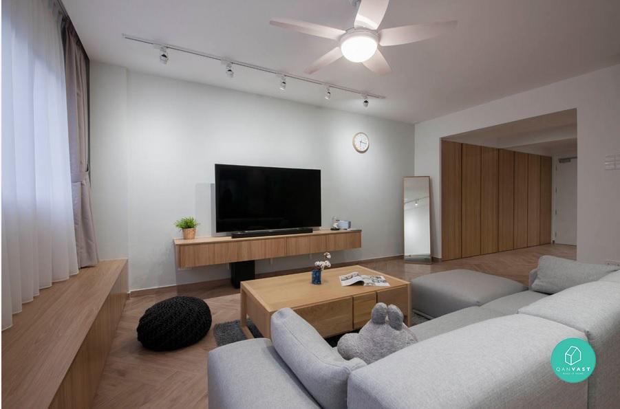

Pictures in my moodboard!
Living room-

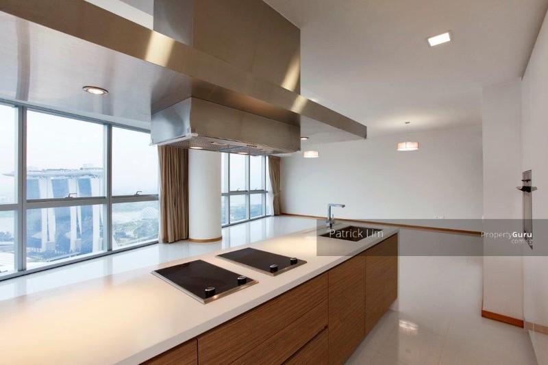

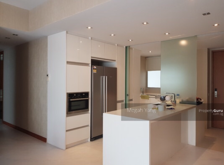

Kitchen
The-Marq-On-Paterson-Hill-Orchard-River-Valley-Singapore2.jpg.d84134781a97c4f3b3092448a4760695.jpg
1087692979_Wetkitchen(whitecountertop)Marina-Bay-Residences-Boat-Quay-Raffles-Place-Marina-Singapore.jpg.3362f69e59096026d432f3d7088924e7.jpg

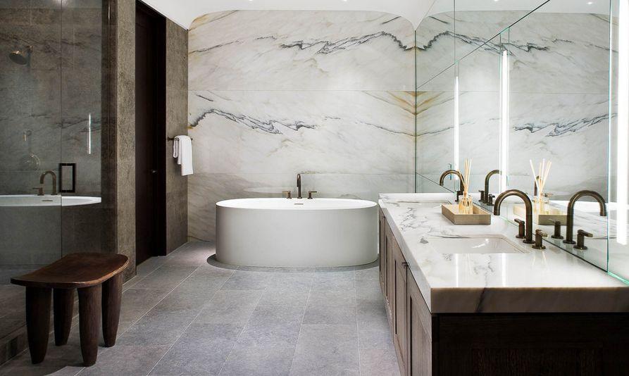

Bathroom
Study room

Bedroom
