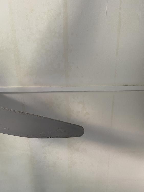

Help! What happened to my ceiling?
Could anyone advise what is happening to my ceiling and what can be done? This is my master bedroom ceiling. Flat is 20 years old.
Is it due to moisture from bathroom? We seldom turn on aircon. Thank you
Edited by Jaz Tse
are you staying on the top floor or is there a neighbour above you?
It does seems like some moisture has seeped through the concrete. Last time my flat was on the top floor and I had similar problem as the waterproofing on the roof has partially failed. If yours is not on the top floor, then you may wish to check with your neighbour upstairs on whether they have recently washed the floor or not.
Very true does look like some seepage has happened
