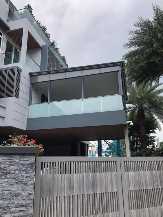

assuming this is the carporch roof terrace, it is not allowed 99 percent of the time. if someone complains to URA then the owner will need to remove. for the 1 percent, there may be already existing landed housing areas which does allow for this covering so houses in these areas would be allowed to have these built.
contractors will just do what they are told and paid to do (after TOP/CSC). they won't care about the legal aspects since ultimately its the owner who is responsible and not the contractor who does the job.
