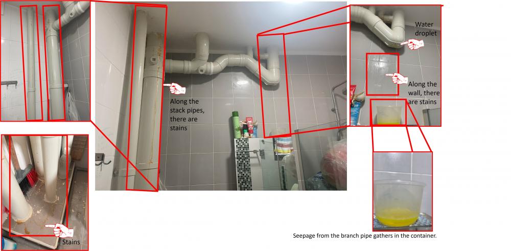

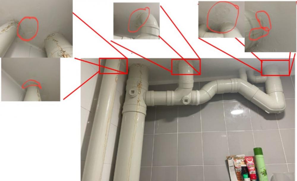

The seepage first appeared in my master bedroom toilet on February 4, 2023. Water droplets began to fall from the ceiling around the stack pipe and the stack pipe itself. I immediately contacted HDB, and they dispatched a private contractor from the 8th floor to investigate the issue.

After six months of enduring this seepage predicament, I am exasperated and grappling with its implications. Water stains have marred the ceiling of my master bedroom toilet and permeated into the wall fixture, compounding the damage. Moreover, I am deeply concerned about the potential health hazards of a consistently damp environment.
