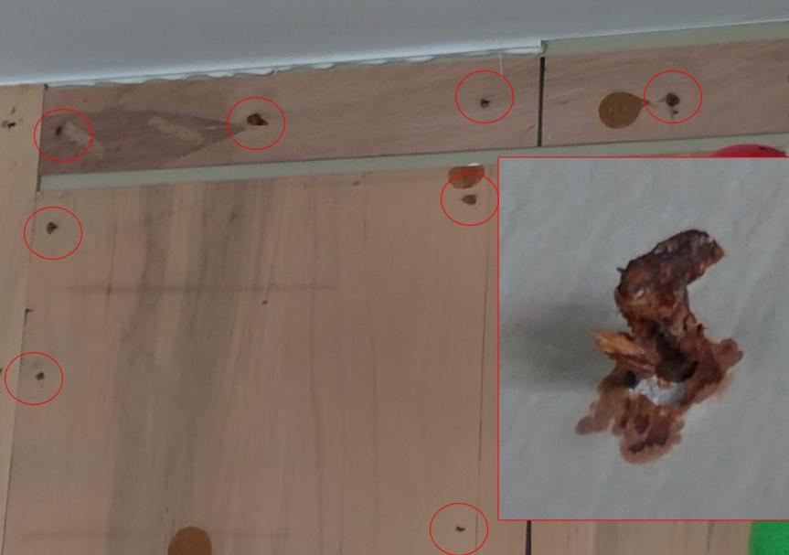

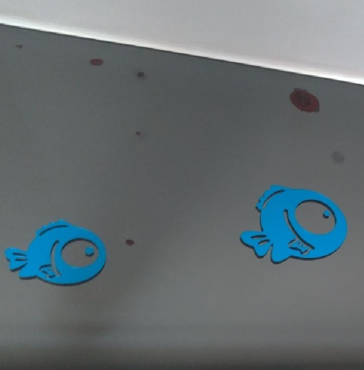

Just an update after getting another ID to rectify one of the flaw from previous ID.
Hacked the full height mirror on one of the side wall in living room due to rust build-up one the backside of the mirrors. Found out the previous ID didn't mask the wall nails that attached the wood panels behind the mirrors, hence the rusty nail damage the backside of the mirrors and showed up on the frontside. Can't imagine if the rusted nails got broken someday and the whole mirrors fall off together with the wood panels while my family is having meal around the area.
