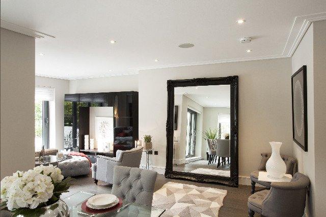

  • However, in order to cover my wires, i have to use cornices and he will place a plasterboard over the entire ceiling area and paint it over.
    (Quite bummed to have cornices and I'm hoping the simple designs will not be so obvious in my home!:( I also pray it doesn't look weird with track lightings...)
Can anyone enlighten me on the pros and cons of Plasterboard ceiling? Thank you!
