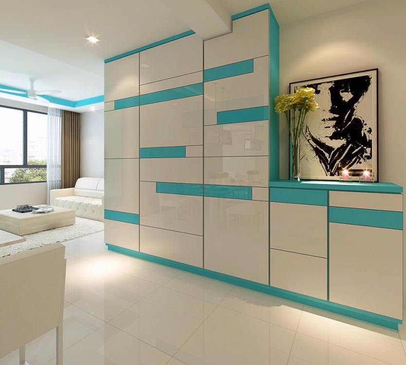

On ‎25‎/‎08‎/‎2016 at 11:44 PM, Magdalenechoo1983 said:
Many pricing abit on high side. Mine 4rm BTO under $27k.. These are some of my 3D...
Hi, yours $27k seems quite reasonable. Did you do anything for your bedrooms & toilets? Does your quote include flooring?

1 minute ago, boom said:
does it includes flooring as it seems low with so many cabinet
I am quite sure it does not include flooring because the pictures clearly shown HDB typical flooring.
