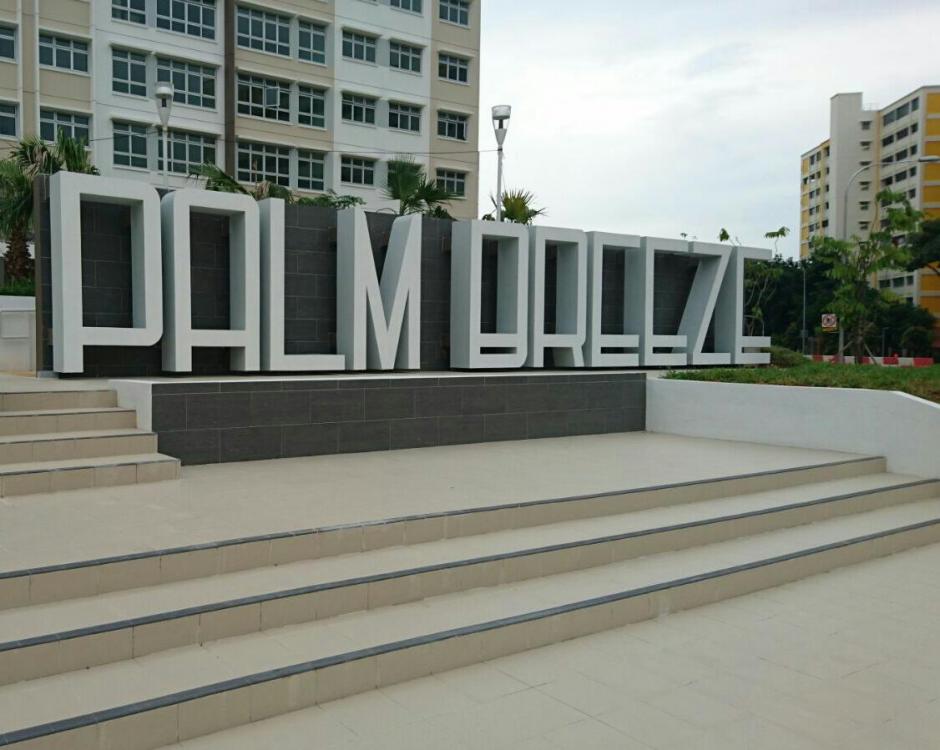

Cosy 4 room BTO at Palm Breeze
Hello there. I'm just super excited about my renovation and wanted to share the journey here.
We got our keys on 4 Jan 2017.
I will share more pictures soon as the renovation and drama (not too much I hope) progresses.
