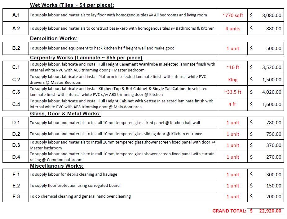

6 hours ago, Emilita Lim said:
How about this? This is from another firm..
Price is reasonable. But all your carpentry come with internal white PVC, no soft closing, casement instead of sliding doors.
1 hour ago, Emilita Lim said:
@Hwmook ya i was wondering about that too.. but the rest seems reasonable enough right?
Yes, reasonable enough. Internal coloured PVC, blum soft closing hinges and sliding doors all cost extras so you might want to take note of that. Usually contractors quote base on the cheapest options then top up as you add on while ID will likely quote base on the most popular options.
