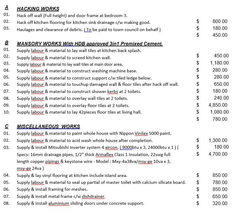

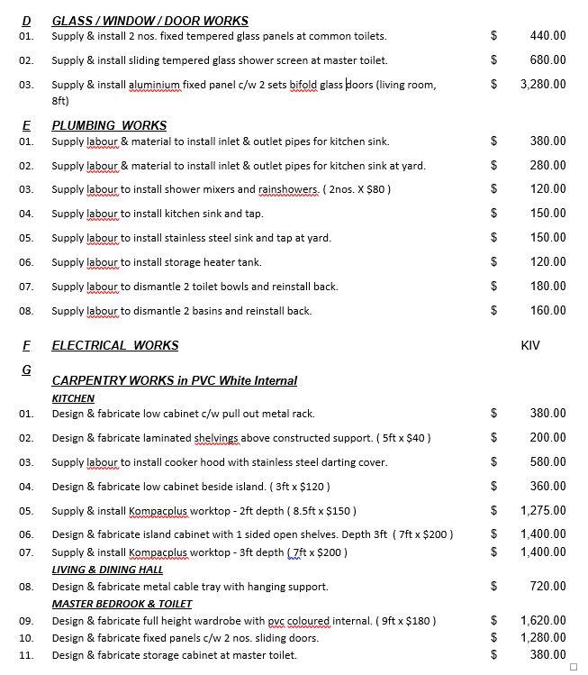

Hi guys,
Please help me to review my quotation.
I have chosen my tiles for the toilet.
Master bedroom & Common toilet flooring is S$4.82/sqft
Toilet walls is mainly S$3.21/sqft
Feature wall in toilet is S$7.28/sqft
Appreciate your comments and if it is still possible to ask for more discount. Mine is a 4-room, 93sqm new BTO with no flooring. Will do cement screeding by HDB.

Hi,
I noticed that there is some hacking at item A01 - bedroom walls. Just to highlight in case you do not know.
For hacking of walls, the contractor will need to apply approval from the HDB. Then the HDB will decide if you require to engage a PE(Civil) to endorse on the hacking. (which will involve some costs which can range from a few hundreds to $1k depending you find on your own or leave it to the contractor.).
It is up to HDB to decide if PE(Civil) is needed or not.
