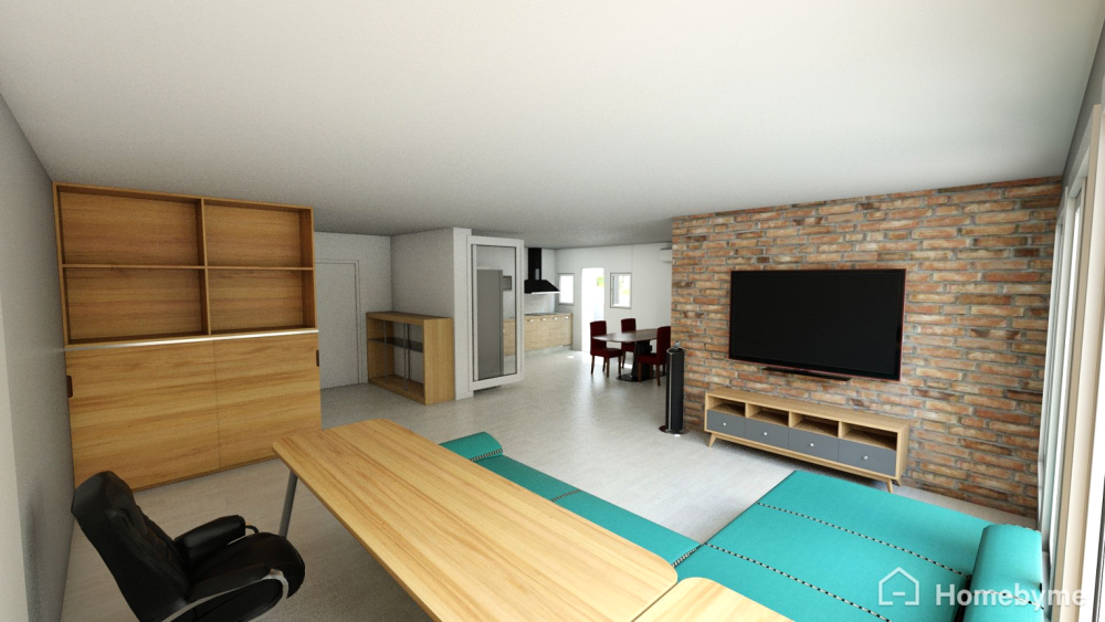

Below is a 2D layout that we designed.
And below are the (outdated) 3D renders made by yours truly.
As we are using a Contractor, all the details are to be thought out by us. There are some major decisions to make which have high impact to the renovation. I shall list them here.

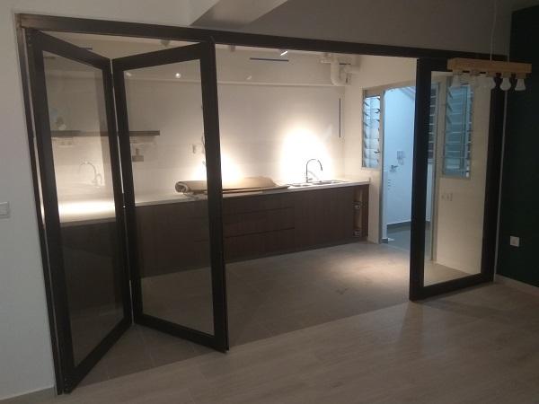

5) Whether to have open or close concept kitchen.
This is a tough question. The pros and cons for each can be found via a Google search. I shall not repeat them here. Wifey and I discussed for a long time before deciding on an open/close hybrid concept kitchen; we will hack away the kitchen wall and replace them with full height, top hung, sliding and folding glass doors. We will leave the doors open usually, and close them if we were to cook or if we were to switch on the living room aircon.

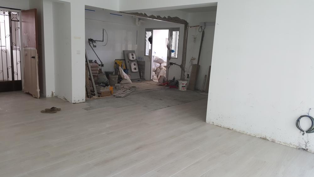

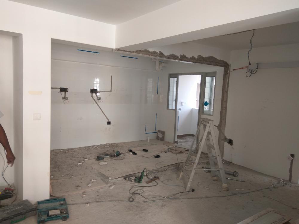

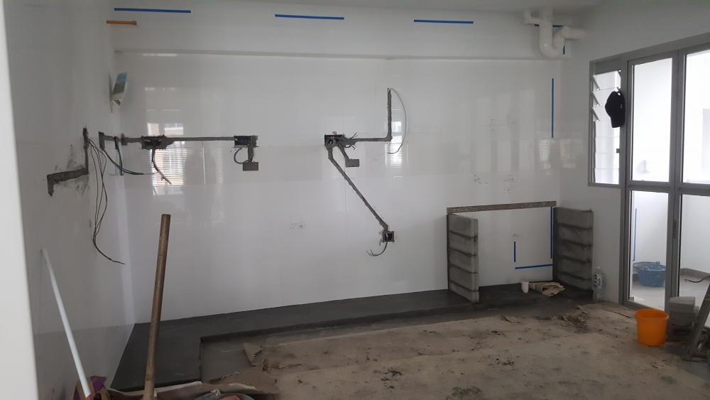

Step 2: Hacking & Electrical works
Step 2 was fast and furious. The kitchen wall was hacked clean within a day. All the electrical works (including relaying of wires) were done together. Did not take much photos as it was over in a flash.

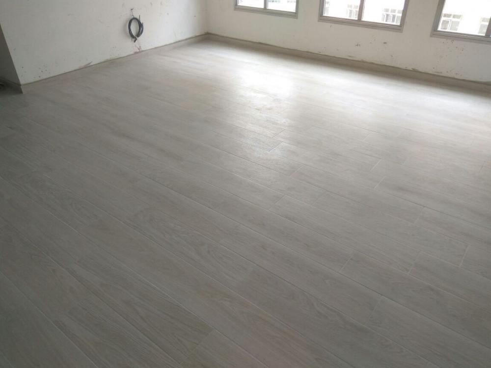

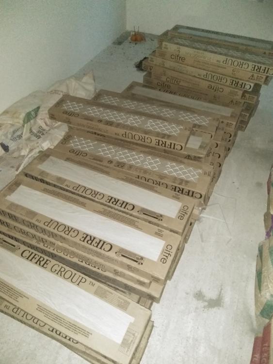

Step 3: Tiling
We went to Hafary and Soo Bee Huat to choose our tiles. Both of them have a wide selection of design. We wanted the look and feel of a wooden flooring and this floor tiles will be placed in the entire living+dining+bedrooms. Below is a sample of the tiles that we shortlisted. We compared it against the kitchen flooring which was provided by HDB.
After double and triple confirming the tiles selection, works for the flooring began.
Screeding to ensure that the floor tiles will be leveled with kitchen and bathroom tiles. In the middle, you can also see the sink that we bought. We wanted an undermount sink and to achieve this, the sink needs to be "wrap" by a layer of cement. Pretty interesting.
Preparing floor tiles for laying...
At the same time, cement base for kitchen cabinets are done up.
Likewise for the cement base for sink support.
Tiling started. For those whom are also using rectangular shaped tiles/vinyl, you will need to decide on the orientation of the tiles/vinyl. Did some research via googling. The longer side of the tiles/vinyl will make your home appear longer. For example, we laid our tiles so that the longer side of the tiles run parallel with the layout of the home, and it spans across all the way from living to dining to bedrooms; making the home look larger.
Another decision is the type of stagger of the tiles. We selected "random staggering" as research had shown that it will result in an illusion that the floor is made of real natural wood rather than man-made.

Final results of flooring.

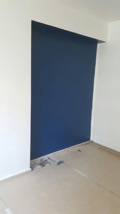

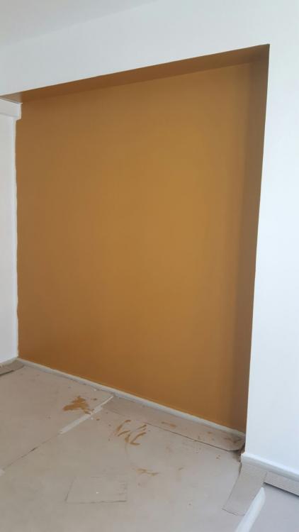

Step 4: Painting
As mentioned above, we wanted our home to look bright, open and lively. With this in mind, we decided to paint the wall mainly in white, with dashes of colours. We went for colours which are contrasting with white to bring attention and life to the home. We used an app from Nippon Paint to visualise the colours before finalising them. We used a Nippon MediFresh paint which has anti-mould effect.

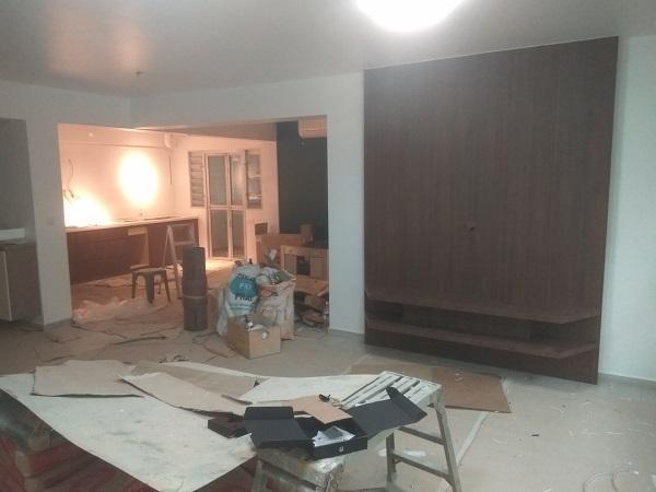

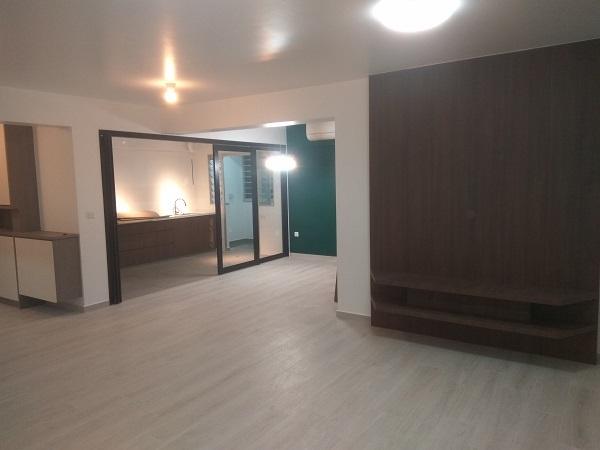

Step 5c: TV console
Initially we wanted to buy a off the shelf TV console. However, we wanted to mount our TV and that would meant unsightly wires due to 1)Power adapter, 2)TV antenna, 3)Google Chromecast, 4)PS4, 5)Steam Link. So we decided to have a built-in TV console to hide the messy wires, and also acts as a support for the TV wall mount (the BTO interior walls are made of weak drywall partition).
For the TV console, the design would be a simple top-bottom plank. I asked for a "cable management compartment" where I will hide all the wires/power extension strips. I will be placing most of my electronic devices on the TV console plank. On the left and right side of the TV console, there is an indent, where I will be installing Philips Hue lightstrips to provide ambiance.
TV console pending installation of Philip Hue Lightstrips and opening of holes at cable management compartment.

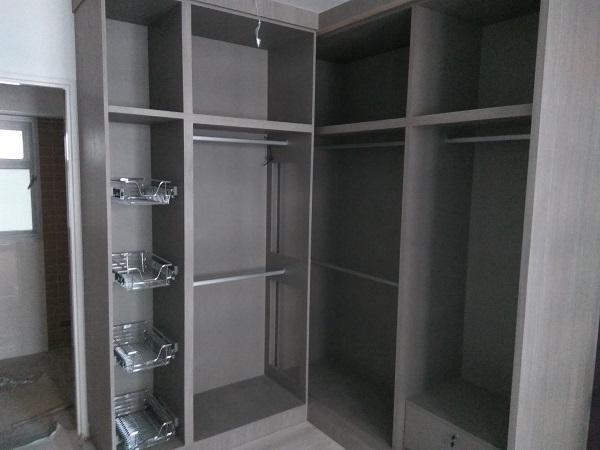

Step 5e: MBR wardrobe
As per the 2D design, we went with a L-shaped wardrobe in the MBR. 1 side would be fitted with sliding doors, whilst the other side would be the swinging door. We also installed metal baskets which can be pulled out. We hope that this can help us to take out clothes which are tucked at the back. We will also be installing interior lights with motion sensor; so that it can help us to see and search for clothes.
MBR wardrobe still pending lights with motion sensor..
