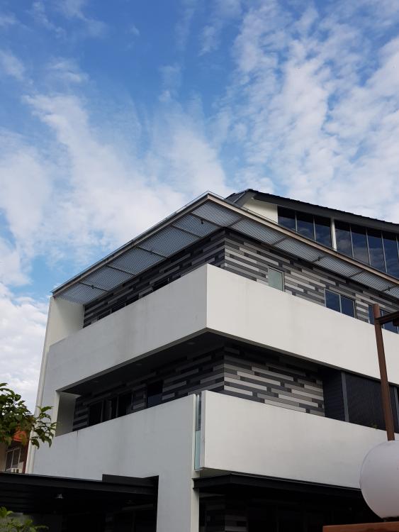

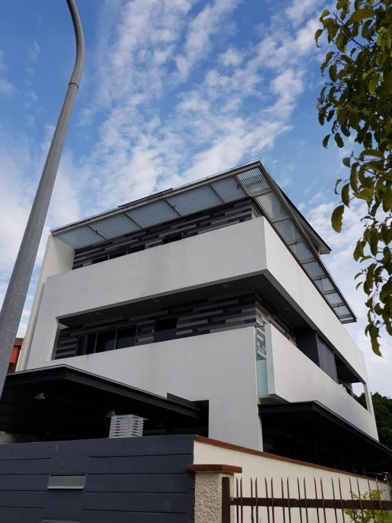

Its was indeed by sheer luck that we got to meet a good builder who has the capability to build up our dream home that we desired, we came across this builder when we first bought the house  when they were rebuilding just across the street of our neighbouring house. We also did some checks via bca directory that they were licensed BCA builder as well as BCA contractor.
Also saw some of the forummers mentioned this builder in the forum in the past thread.
We got our house rebuild in 15 months even though the contractural agreement for rebuilding the house would take 16.5 months.
Some of the cost involved were marginalised due when we haggered the prices down with the contractor but he was a guy whom know his stuff well, most of all no headaches or nightmare as posted by some of the forummers here.
We got our house done at $320psqft for our house of 5100sqft which comes to $1.6m which covered basically everything in the house inclusive of carpentry items which was really a good deal for us.  Most importantly, there were none or minimal defects as the house was build to perfection by this builder and no V.O cost as their contract was clear cut and no cutting around the corners and no delays.
Due to our busy work schedule, my wife and I did not have the time to pop by everyday to catch up on the progress, but this builder keep us up to date with his project schedule and informing us the critical hurdle in each construction process progressively.
This was indeed a blessing for us as we would have be in utter chaos should we try to go for the lowest priced contractor from our past experience with other bad builders.
