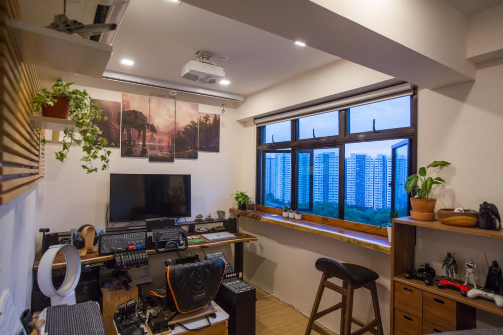

The bedroom is turned into an office/game room with my gaming computer and flight simulator, with a bar table along the window. I am lucky to have a pretty decent view so the bar table is a great space to have breakfast and enjoy the scenery. Both the table and bar table are suar wood, and are one of the few extravagances I allowed myself.

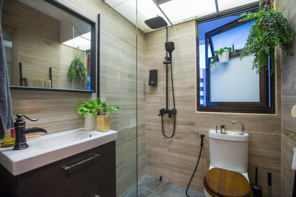

The bathroom is a zen space with wood like tiles on the walls and stone like tiles (from Hafary) for the floor. Mirror and sink/cabinet are from IKEA. I bought most of the fixtures from AliExpress or Ezbuy, which can be a gamble but definitely saves a lot of money. The emphasis is on clean uncluttered design.

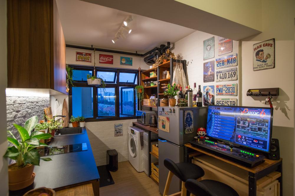

 The kitchen pantry is a customized IKEA IVAR system, with the frames painted black and the wood varnished to give a more industrial look.The fridge is small but definitely enough for one person. You do not want an oversized fridge to dominate your kitchen.
Yes I even installed an improvised arcade machine in my kitchen =D That way, there is a reason for friends to hang out in the kitchen and not crowd the living room too much. The car plates are from my time in the US, and most of the other metal posters are bought from Aliexpress. The original kitchen walls are overlayed with white brick tiles from Hafary.

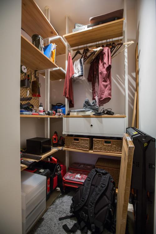

The bomb shelter has been converted into a small walk in closet, very much inspired by ryanyth and his blog. The system is ELVARLI from IKEA, and works perfect. It is also a place to keep the tools for the many DIY projects I do around the house.

    My flight sim console is the centerpiece of my gaming space ? The components are made up of bits and bobs I have collected over the years.  The table space is pretty much taken up as you can

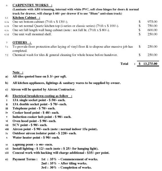

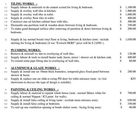

Here are the quotes from my contractor
1384051895_Quote1.jpg.a65c6ebb1d90a4f999fc69412f2a3a0a.jpg831706186_Quote2.jpg.29011377988500a71d549830d2dd7f31.jpg
I thought the contractor quote was very reasonable and work was generally quite satisfactory except when we hit a huge roadblock with the flooring, which dragged the renovation out to 6 months.
I opted for vinyl flooring since I was reassured that it is a solid option with no hollow sound or feel common with wood laminate flooring. Furthermore, It's durability, cost and resistance to water beats out wood timber which I was also considering. I also went for the more expensive Evorich vinyl tiles but please be warned that your floor screeding has to be done well for a good result. My contractor could not lay a flat floor, and there were many places that felt uneven and had the horrible hollow sound. Because Evorich vinyl tiles basically just lays on top the existing flooring, preparation is key to get a flat floor. So I told the contractor to tear up all the flooring and to patch up the trouble spots. I was around to supervise the work and it was pretty obvious that the workmanship just was not up to par. They did not seem to know what they were doing. I consulted the Evorich guys but I get the impression that they are more interested in getting me to agree to the shoddy workmanship than solving my issue.
In the end, I got so frustrated and disappointed in the workmanship that I personally had to mix the cement and patch up the floor flat, with the help of a 6 foot ruler that I got from a hardware store. Yes, the contractors did not even have a ruler to help them gauge whether the floor is flat. It was quite the effort but I managed to get the floor within specification and was thankfully happy with the final results upon installation. I have heard that other companies use vinyl that is installed over some kind of foam underlay, and that will mitigate the problems of an uneven floor.
Needless to say, this episode brought friction between me and my main contractor, but to his credit he did waive the fees for the screeding and give me a discount for the flooring. Judging from the effort I put in, I must say it is a fair trade.
I also had the time to go supervise the work pretty often. My main con was hardly around, which was disappointing. My advice is to stick by your guns and not to accept shoddy work. Some may entice you to accept by offering you a discount but you are the one who have to live in your home for many years to come.

My flat came with an eco tap for the toilet. The idea is for you to wash your hands with the water that is used to fill your cistern after every flush. But I find that it’s a bit awkward to use and I normally wash my hands with soap at the sink anyways. So I turned the eco sink into a little diorama of the bus stop scene from Totoro.

Tool rack in closet. DIY culture is sorely lacking in Singapore. You can save quite a bit of money by customizing your own little furniture.

How long have you stayed at your place?  I see you have done a little glass screen next to your sink.  Do you have enough space to clean the side of the cabinet?  What space is still dry after you have showered.  I was advised by Id to put screen on the toilet seat side.  How much did your tempered glass screen cost?  Notice you don't have a floor curb.

As for the bathroom, I made sure that there’s enough room on both sides of the sink to clean the glass. I have about a 10cm gap for that purpose. I kept the size of the glass panel to a minimum - as long as the shower doesn’t splash onto the sink and vanity. It does splash a little but it’s a compromise I chose to make. I could have made a shower enclosure but it would just be too tight for such a small bathroom. The toilet is meant to take a little moisture anyways.

Great!  I will go check out the roller blinds since they are light.  Thanks for the detailed quote, most helpful I can use that as the benchmark when I start sourcing.  Mine is a type 2 but same layout.  Expecting to get keys early next year.  Getting tips from the 2roomers on YouTube and Reno talk.  So I will definitely be checking your blog for your updates.  Many thanks for your responses.
