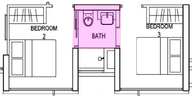

Folks, able to advice whether possible to convert an en-suite bathroom into a wardrobe ?

Actually this might be difficult due to the plumbing especially for the sanitary pipes, because even if they cover it with tiles, there would be an issue with smell and moisture, i am of course assuming you are living in a condo or hdb, but if you are living in a landed property then it might be of a different issue
