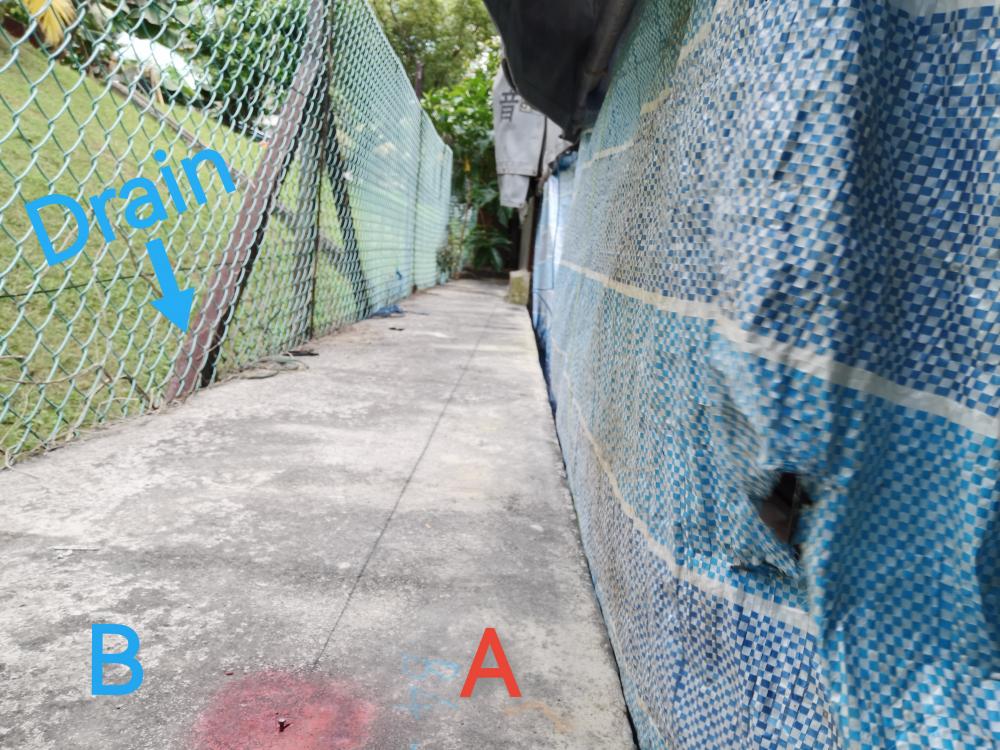

Hi, I have an enquiry here regarding rear shared boundary with a global school.
Referring to the pic, we have a shared slab of concrete, the boundary line is on the slab. My side is marked A. There's a drain just beyond the fence on side B.
I want to erect a wall where the canvas is with a sloping shelter to direct rainwater...
1. Can my shelter cross the boundary line? And I erect my wall up to the boundary line?
2. Can I do rectification works on the concrete slab? I'm thinking of adding an incline on the slab to direct water flow to the drain.
Thanks.

 Since this is the boundary wall, your shelter should be set back at least 1m away from the boundary line. You CANNOT have your shelter protruding over your wall due to this set back requirement.
you cannot built over your boundary line as well since it is considered encroachment. If the government does a site survey in future, you will be asked to remove any encroachments and make good at your own cost as well
you can get your builder to add cement to create a slope on your side of the boundary line to help redirect the rain water.

Thanks @snoozee
So I can extend my wall at the boundary line, BUT the shelter has to setback 1m from that wall.
Yes, I'm the place in the east.

technically your wall can be built all the way to the boundary line. but your builder may set back by about 5cm from the boundary line just in case of construction errors so that the post construction survey will still show the wall within your boundary instead of over.
the shelter roof edge must be at least 1m away from the boundary line. if your wall is set back 50cm from the boundary line, your shelter must still be 1m away from the boundary line meaning the gap between the edge of your shelter and the outside edge of the wall is just 50cm as opposed to 1m. the guideline reference is the boundary line and not where your wall is.
