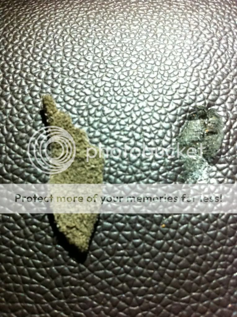

1st photo show the different in surface and colour.

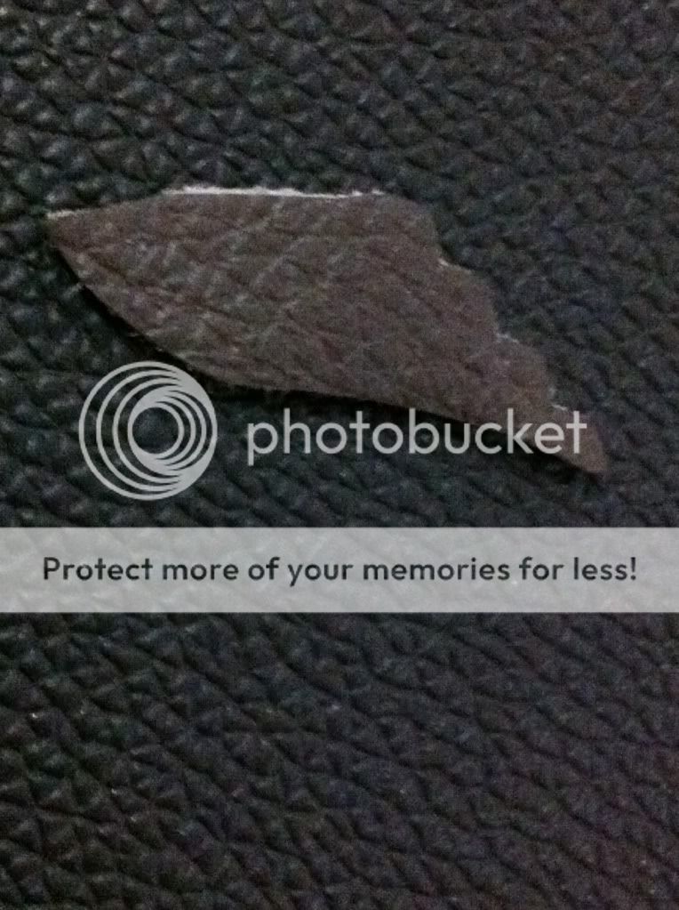

2nd photo show that there is a hole on my armrest when it is delivered.

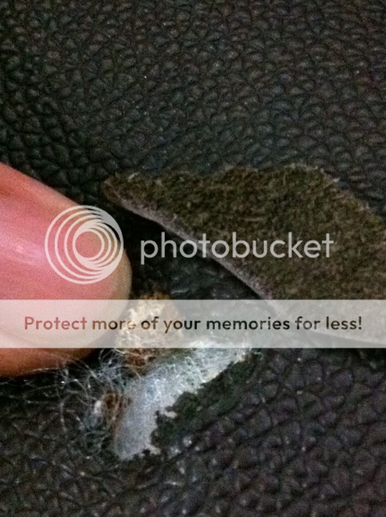

3rd photo show the underside difference in my sofa and leather sample. The area where my finger is, the brown side is flaking off like some kind of small bits.
Dave can help me see what is this?? or anyone is able to advice as well.

1st photo - Is the leather sample colour and texture what they had promised that you will be getting? Cannot tell the quality of the leather from the first photo but can tell from the leather grain pattern that it is not natural as it is printed.
2nd photo - The hole is caused by something hot like a lighted cigarette. But the leather is of a very poor quality as reasonable quality leathers should be able to offer some resistance against burns by hot objects and not have such severe damage. Looking at the underlying part of the leather that has been exposed by the burn, it appears that your leather sofa is bonded leather as I can see bits of the fabric for the adhesive backing. The leather sample looks like split leather.
3rd photo - The 3rd photo is taken from which part of the sofa as it looks like it is an additional damage? I assume the white stuff is the filling for the sofa. That type of filling is cheap and flammable. The brown flaking is normal for poor quality leather and it is clearly not top grain leather.
Summary - It is not PU leather but either Bonded leather or a very poor quality Split Leather based on the photos. If I get to see it in person, I will then be able to confirm which is it.

The 3rd picture is from the hole from the 2nd picture, not addition damage. I flip the hole so as to allow the photo to be taken as to compare.
