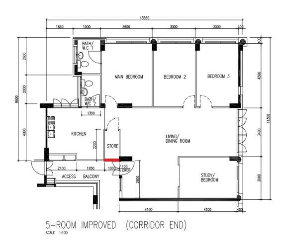

I'm looking to buy a resale flat but would like to change the location of the main door.
I have attached the floor plan, as you can see the red area is where I would prefer my main door to be.
Does anyone have an experience of HDB approving this type of request?
I already emailed HDB and they want me to purchase the flat first and submit the contractor drawings....
Let me know you're experiences!
Yes, you can change the location of the entrance door as long as the wall is not a structural wall. However, you will need to engage a PE to do an assessment and then PE will submit the application on your behalf to HDB for approval. Please refer to my postings on my experience.
