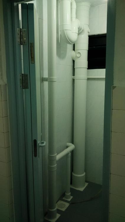

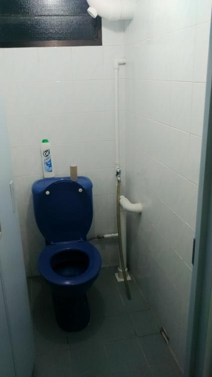

can these pipes in toilet be moved?
Would like to check with the bros here to see if the pipes in the images can be reroute in anyway? the toilets are side by side separated by a wall. I intend to hack partial of the wall off to create a walkway to link both toilets together. Understood that the sewage pipe behind cannot be touched, what about the front pipes or the smaller seconday pipes? Please advise
Only the inlet pipe (the smallest pipe in the corner) can be moved.
In other words, you can make a window to see the other bathroom but not a walkway.
