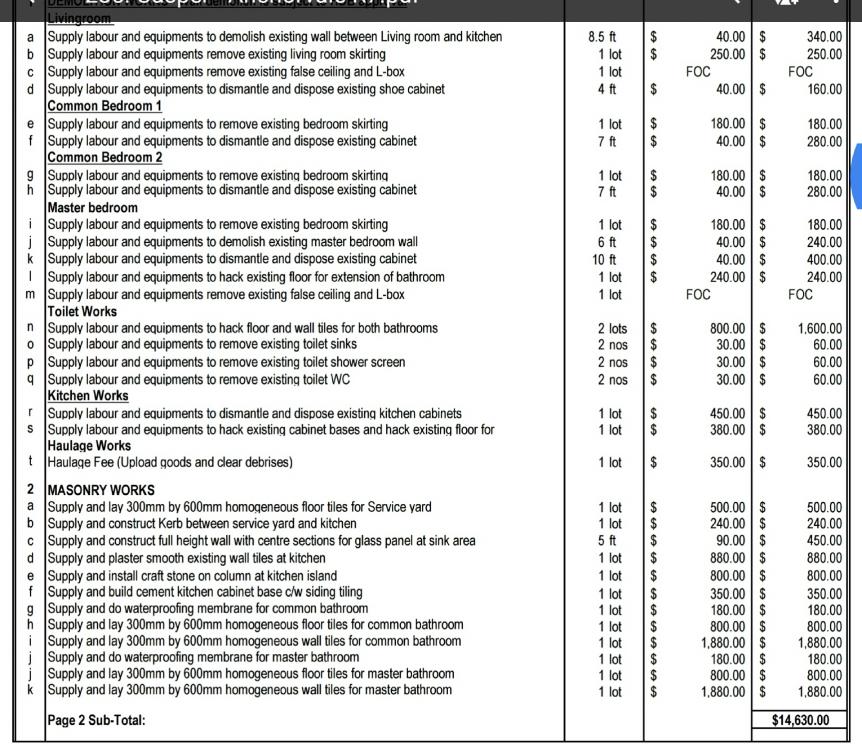

Opinion on this quotation
Hi all, can I get your opinion on this quotation please. It's a 5 Room resale HDB about 110sqm. Not looking for the cheapest quote in town; just don't wanna get ripped off! Thanks guys.
All ok except kitchen cabinets pricing high. Overall ok.
Thanks for all the replies so far. I could use a few more opinions!
@Hwmook And that is with white PVC for internal shelves! :(
Maybe you can highlight to the contractor and see what he can do. It seem most of your quote is really low except for the kitchen cabinets, my ID quote me for cabinets with blum soft closing and internal colour PVC is about $130 pfr.
