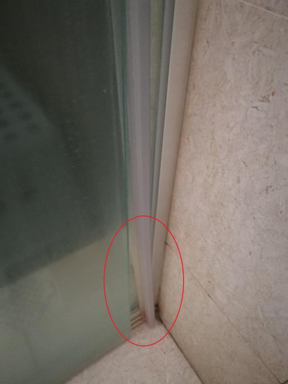

What to use to seal back the rubber of bathroom transparent door?
Does silicone help?
(Can see the picture attached?)
Can just use coloured silicone which i your case should be black
mine came out too last week. I did not use silicone, just use force to push the rubber seal into the glass panel. It is really tight, once in place, it should not come out easily.
The rubber strip might be too long. You should check & make sure it is not scrapping the floor/track. If it is, use a pen knife & cut off a few millimeters.
Like RobinHo0d suggest, push it back against the glass. If it does not stay in place, a little super glue at the end should do the job.
But how did it come out? Just due to normal usage?
