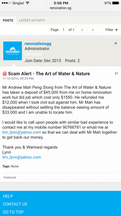

In fact, this Andrew MAH is the project manager of MAXZO! He just pretended to sound like he was one of his clients.
