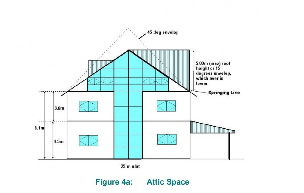

2. not sure where you got your 15m from. below is a picture from URA guidelines from 2011 which indicates the max allowed height of the storeys for a 2 storey landed house. The current max height limit is 12m. there is no way URA would allow you to retain the current height of the house once you change the roof profile. Their answer to you is that you have to follow the existing regulations. it doesn't matter what was done in the past as old regulations can't be applied anymore. If you want to "flatten" your roof, then you can only keep it within the red dotted lines which I've indicated in the 2nd picture as this is the current building envelope that URA allows for landed houses. So you can have a flat roof on top and then have open balconies at the areas where the slopping lines are at. Assuming the existing attic is 5m high from floor to the peak, you would need to drop it down by 1.1m. but your attic would still have a height of more than 3m internally which would be more than comfortable.
