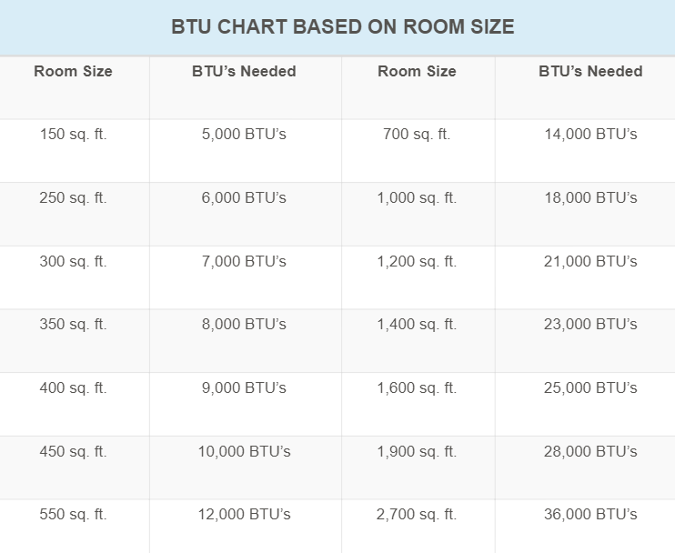

don't combine your floor area when calculating aircon cooling requirements. break them down into individual rooms.
a guide to calculate the BTU is to take the total area in square meter, divide by 5 and then multiply by 3412 to get the BTU.
eg: 20sqm room will require 20/5 x 3412 = 13648 btu. so you can get an aircon with wall unit which can provide at least 13K btu
going by the above calculation, your mezzanine room of 848sqf will be about 80sqm which gives you at least 54k btu required. so your plan of one 14k btu unit is hardly enough.

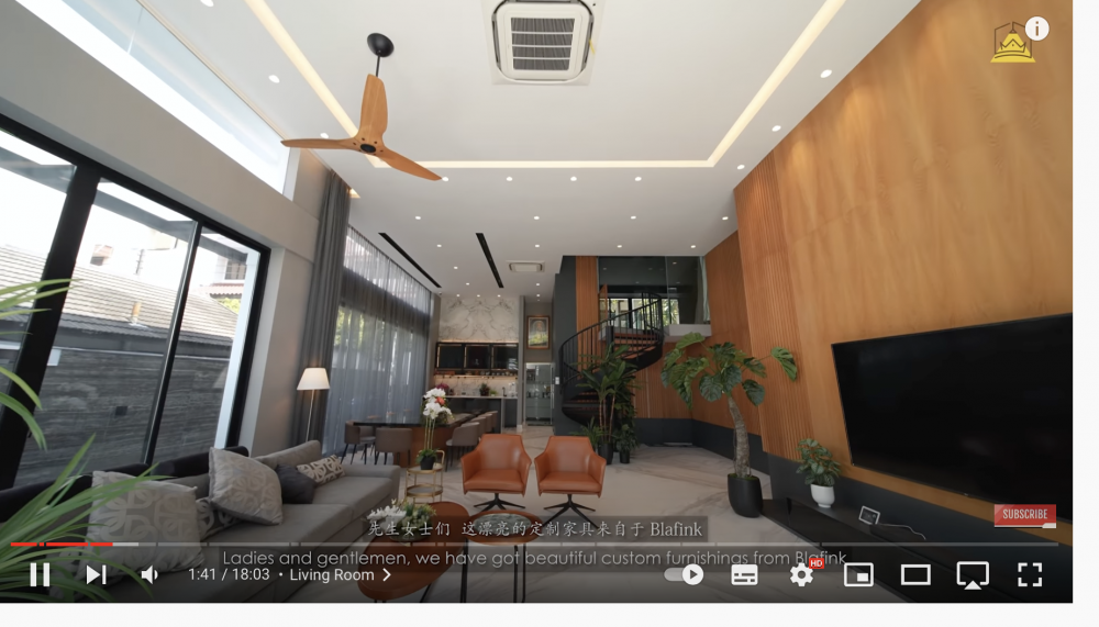

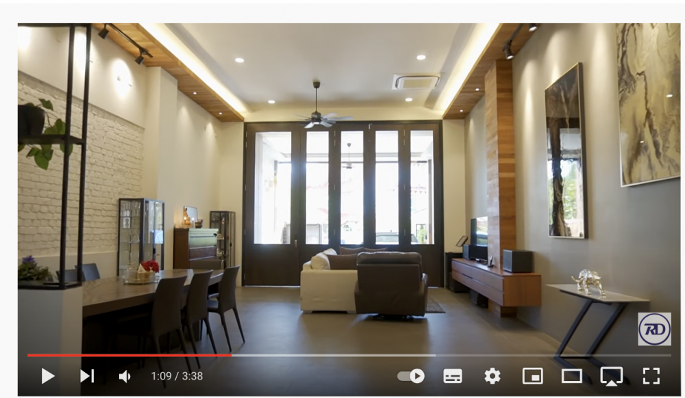

I note that you have a double volume living room and you plan to have a ceiling cassette aircon installed. Are you planning to have the ceiling cassette installed in the double volume space or at another area where the ceiling height is lower? Assuming your floor to the floor of the upper storey slab is 5.7m, after deducting the slab thickness of about 20cm and your drop of false ceiling of another 40cm so you can install the ceiling cassette aircon, your aircon will be about 5m high. how are you planning to do the maintenance? This means your aircon contractor will need to bring in scaffolding in to access the aircon every time maintenance is needed and this will cost you a bomb. you will be better off installing wall mounted units or ducted aircon which comes out from the side of the wall instead. Also your floor area is huge at 186sqm. going by above calculation, the required BTU is about 127K which would need about 3 condensers.
Thank you so much snoozee for the insights. I was looking through videos of double volume houses and notice most of them use the ceiling cassette. I was also wondering how to maintain the aircon!!
how do these owners clean their aircon hur????

don't believe what is mentioned in the videos. 6m or 7m high ceiling is exaggerated. comparing the scale of the items in the house, I would say the first house has a ceiling height of just over 5m (instead of 6m) where the 2nd house has a ceiling height of less than 5m (not 7m)
anyway if you don't use the aircon that often, you don't need to service it too often as well. Maybe the owners just do major servicing every 6 months and of cos need to pay for scaffolding la. Anyway the first house boss owns a reno company as well so maybe can easily get his workers to bring in scaffolding as and when is needed so not a big problem.
