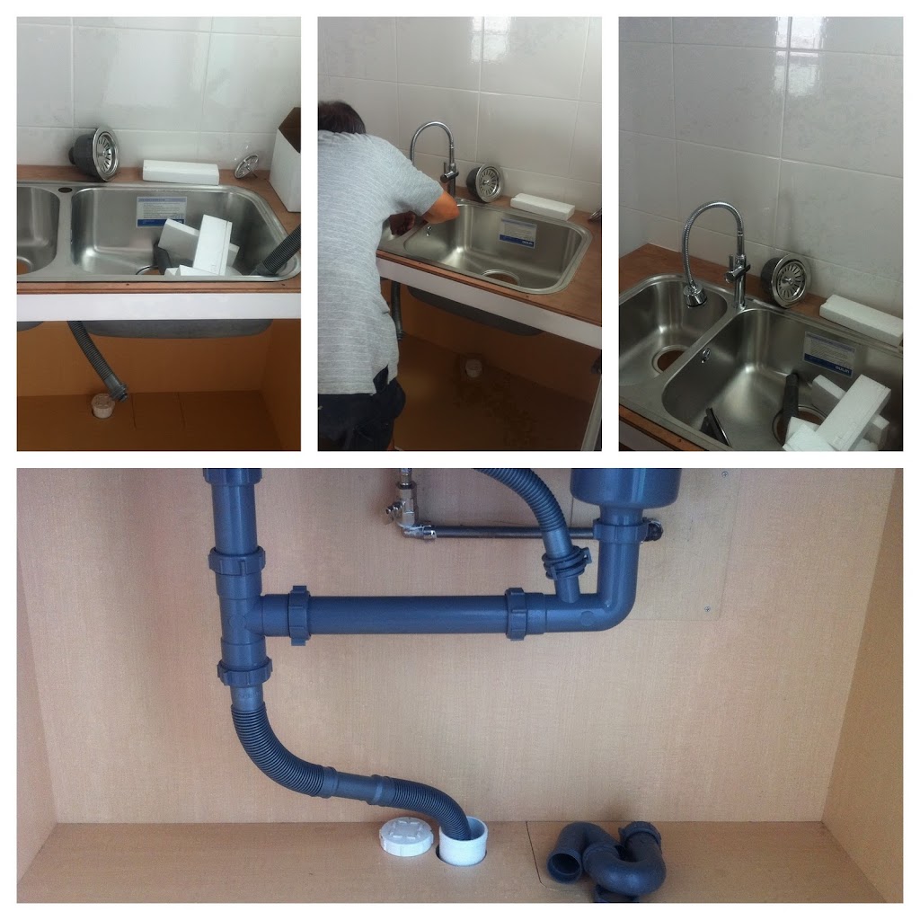

Hi guys quick question - my plumber installed my kitchen sink. The pipes provided are these grey ones. The drainage for the sink is this white pipe. So my plumber said they don't fit so this is his solution.
I'm not too happy about this. Ayone knows where I can get a (layman's term) white pipe to grey pipe adapter? Think I'll be hitting the hardware shops tomorrow.....
Why don't you go back to Hoe Kee, where you bought the sink, and seek their help to find you a solution? Next helper is to find your plumber..

KristernM >> that's my last resort because I have a feeling they won't be very helpful. For instance they should have known this is going to be a common problem but no warnings or advice from their side at all. Good thing is everyone can learn from my experience and be proactive when buying sinks. My plumber wasn't much help - the above was his solution.

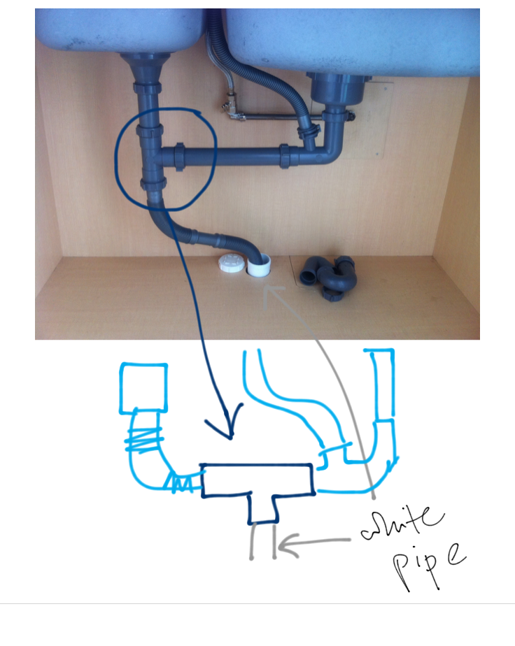

Alternatively you can diy like so

Therat >> I think this is what rmg means, did I get this right? I will try!
Rickoveron >> if hoe kee cannot help me, then I will have to do this myself.... Don't think I can rely on plumbers, they're not cheap and I've been itching to do some diy
Hi, yes this is what I meant. I hope it works as it's hard to tell pipe lengths from just looking at a picture. If there is anyway you can squeeze in the U-bend I see lying on the cabinet base it would be good. This double U piece can help to adjust for verticle orientation differences between your grey and white pipes and also act as a water trap to stop unpleasant back odours from the drain pipe. Good luck.

Rmg >> nope I checked today, all the grey pipes are one size and the white pipe is another size (2 1/2 inch). I also die die want to use the water trap (googled and found it's called a p-trap).
Was at homely hardware but they don't carry pipes. They did have drain covers tho. I will try and make time to go down to those hardware shops with pipes but schedule very tight this week for work and house matters. Will keep updating as I go, thks for all the feedback and suggestions :)
