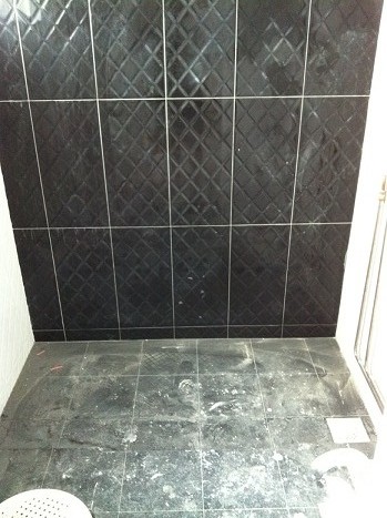

MBR Toilet
We just realized that the MBR toilet tiles didn't match the grout lines at all. We can't accept this.
If they had started all from the same side, then due to small differences in tile sizes and shifted the lines, then we got nothing to say. But now.... Floor tiling starts from the left and Wall tiling starts from the right. Nowhere in the entire toilet can we see a single matching in the grout lines.
Solution: Kok says he'll get his tiler to overlay and try to match the grout lines. No choice unless we would consider hacking again. Not perfect but I guess we have to accept this. Be positive means double protection of waterproofing?

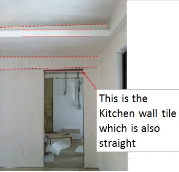

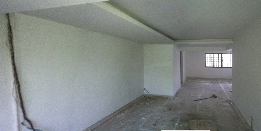

False Ceiling
The false ceilings are completed. However, the leveling is a problem. Sun Hup has done in with laser levelling device showing a perfect horizontal levelling to the FLOOR. It's so called, "water levelled".
BUT, my ceiling and beams are all slanted. With a levelled false ceiling.... now everything looks out of place. The kitchen they say no choice due to tiling will show significant slantness. Now, even living and dining?
Solution:
For dining room view, Kok says that he'll box up the beam to make it look straight so that both the kitchen tile area and the false ceiling looks aligned.
For Living room, the false ceiling will be redone up to follow the beam/ceiling.

The slanted false ceilings are corrected. Now they really look much better. The entrance of the kitchen wall was also straightened.
