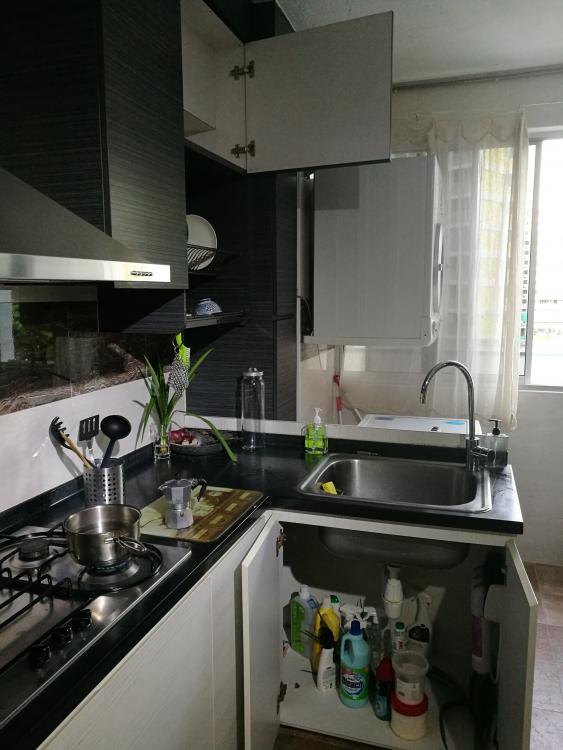

This is the layout I mentioned.  The location I intended to wall mount the water filter system is the space behind the tall glass container.  I think the plumber can cut/drill a small hole for the water tubes to pass through , and make a small opening at the back of cabinet below the sink to connect the water tubes to the water pipe?
I just discovered an unused boxed up area above the dish drainer that might be an ideal location for putting the water filter system out of sight. Do you think  there will be water pressure issue??

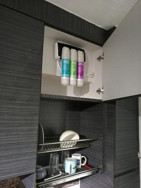

Hyflux's senior engineer just did a site visit.  He will ask the plumber to change out the one month old carbon filter,  the tubes and move it to the cabinet above the dish drainer in two weeks time.
Thanks for all the advises.  Will keep you guys posted
  • 3 weeks later...
Done! Hyflux's plumber spent 35 minutes to relocate the water filter system to the new position,  and changed out the three 1+ month old filters
This Chinese uncle said he always advise the customers during installation not to put the water filter system near household cleaning liquids , and open the cabinet door to air the cabinet when the air gets stale.  The guy who installed mine didn't mention the care instructions at all
