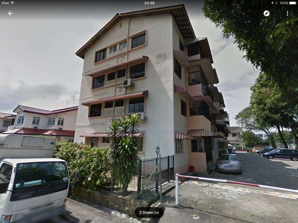

Thanks for the info. This is an old building not newer then 70's. where can i purchase the building and structural plans, also URA i suppose? Attaching photo of the building in question.
plans can be purchased from BCA. but it seems that not everyone can purchase the plans.
as mentioned, best is consult an architect on whether there is still available GFA for you to build the loft or not and then consult a PE on whether the existing structural can take the load of the additional 40sqm of loft area. reinforcing the columns and beams in your unit may not be enough for the columns and beams in the lower units to support the extra load.
