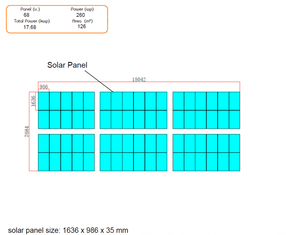

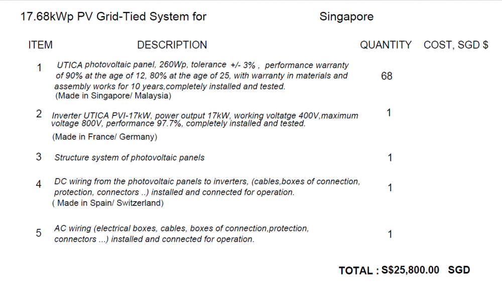

I've a quote from UTICA for my newly build (under construction) semi-d.  It will be good if we can get together and ask for a better price as a group.  PM me if interested. :)

what is the coverage area of the PV panels for your house?

This cost includes connecting to our power grip such that excess solar energy can be exported and sold to the grid to offset your utility bill?
Coverage area 126m2.
I believe it is included.  PUB will install another meter in the meter compartment for exporting the excess.  Understand that have to lay the cables ready when construction.
