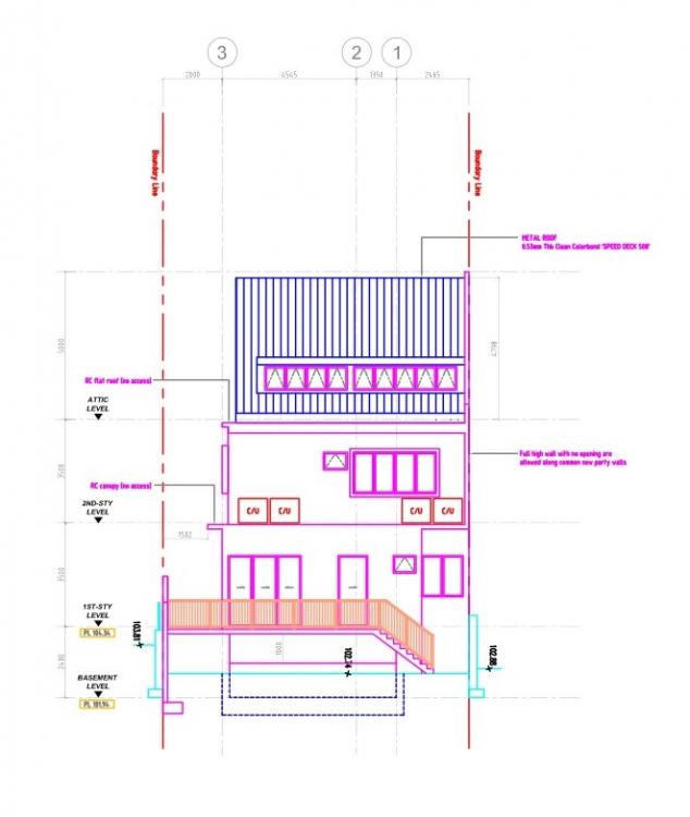

Look at the Architectural Drawings you should have Elevation/s & Sectional drawings showing the height of all floors.
For example, in bottom left of my attached Rear elevation, you should see under "Basement Level" a rectangular box with wording "PL 100.94" This means the completed floor level (after complete laying of floor tiles) of the basement.
From PL 100.94, you add the dimensions at the left sides of this elevation (ie: basement to 1st = 2480 means 2.48 metres) as follows:
100.94+2.48+3.5+3.5+5=115.42
Hence 115.42 is the highest "Reduced Level" of the property. In the plan, PL means Proposed Level.

3) In my elevation, the calculation will be 100.94+2.48+3.5+3.5+1 (assume 1 is height of basin tap from attic floor)=111.42
Hence based on 111.42, we know there is no need to install water tanks &/or water pumps.
