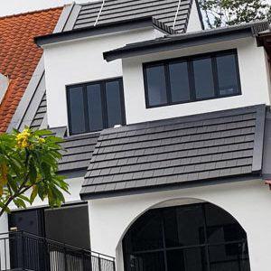

Thanks Snoozee. Did you consider the tiled roof option before deciding on metal? Was tiled roof more expensive? i found this pic online, which seems to suggest this is metal roofing. Looks like a compromise if so.
I find tiled roof nicer looking but the slope means i got to compromise on ceiling height inside. But can i decide how much to slope?

your photo seems to be sheet metal roof stamped to look like tiles.
