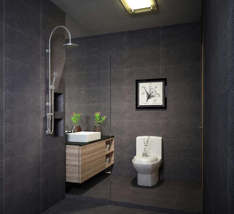

5. MBR bathroom
its slick looking but i don like the color theme, its too dark, more like hotel than my house. i want lighter colors to match our house theme (i.e grey, light grey etc)
overall i give 8/10, just need to change the colors.

Master bathroom:
still looks too dark for me, maybe just leave the feature wall and flooring dark, the rest i want lighter colour.
what do you guys think of the 3D? any suggest to make it nicer?
