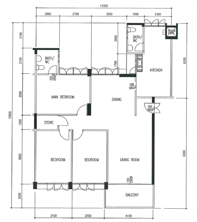

Here's the floorplan. It's a very standard old 5rm flat. It's quite lived-in, and while the condition is not shabby, it definitely looks a little dated for our taste. No pictures of the current place, out of respect for hub's parents. Anyway we have grand plans for the apartment so the pictures will be irrelevant!

your flat is somewhere near eunos/kaki bukit?
the floor plan is exactly the same as my previous flat! :)
50 minutes ago, lavendercupcakes said:
@snoozee, it's in the west but not quite near eunos!
Maybe a lot of apartments built in this era have the same floor plan?
haha ok. your flat should be built around 1982 then. last time HDB design is internal "cookie cutter design" unlike now where they engage private architects to design the flats.
since you like to cook and bake, you would love the kitchen which is huge compared to flats built in the last 20 years.
the rooms are also very spacious as well to fit queen size beds and even a king size bed in the master. if you don't need the store room, can even hack down the wall to add in a walk in wardrobe. :P

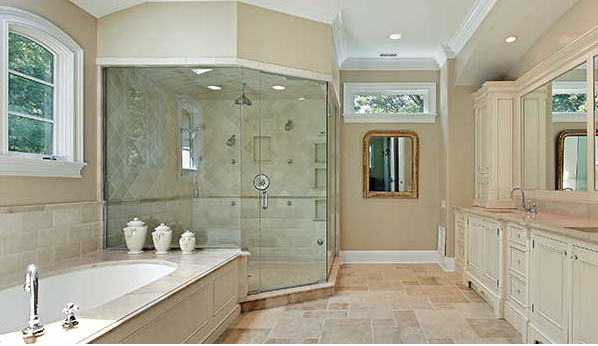

  • Big, full bathrooms with 2 sinks and bathrub. HDB toilets are tiny compared to what we were used to. Most bathrooms in the US are the size of a bedroom here, and they come with a separate bathtub and shower. Many also come with double sinks, so that 2 people can get ready at the same time in the morning. Again, this is something very unusual for houses here, and it is gonna be challenging (and expensive) to build, but hubs and I like to spend quality time together in the shower, so this is important to us. As a reference, this is the kind of concept we are looking for (but probably not possible to make it as spacious as this):
Another example, less spacious and slightly more attainable:
Another idea is to use the "toilet" space for shower/bathtub, and use part of the bedroom space for the sinks:

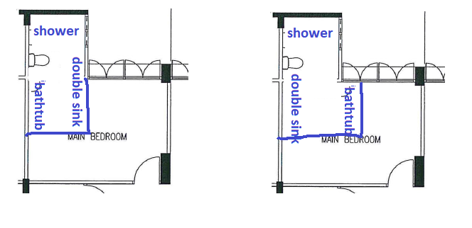

This took up a lot of discussion time with the designer. We learnt the following:
1. It is not practical to expand the second bathroom in the kitchen into a full bathroom due to the layout. Even if we are willing to eat into the kitchen area , it will still affect ventilation and light in the kitchen. The other option is to put the sink right outside the toilet, and use the inside space for a small dry shower, but this looks ugly. We thought about it and realised that this bathroom is most likely only going to be used as a toilet by guests, so we decided to leave it in its current layout. We intend to leave it as a wet shower, in case we ever need a second shower.
2. For the master bathroom, the best way to get a full bathroom is to knock down the main bathroom wall and use the bedroom space to make a bigger bathroom. It is much harder to move the sinks out, because of the location of the water pipes.
3. It is not advisable to move the location of the toilet bowl because, again, the pipe is fixed. This is a very big restriction, and we will have to plan the bathroom around it.
After discussion, we realised there were two main options to get what we wanted:
The option on the left means that the bathroom is a little squeezy. The option on the right gives more space, but it also sacrifices window space in the rest of the apartment.
In the end, we decided on the right option. Our designer said that the left option would be much easier, but even if we get slim bathtub/sinks, we only have about 80cm width in the "aisle", which is very narrow. So we went with the right option. As a bonus, that gives us an extra window in the bathroom for ventilation, which is important for the walk in wardrobe (see next section).

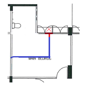

The designer did warn us that this would require some way to seal off one window pane, which would need to check with HDB. The designer said that there were a few options, depending on HDB's approval, but told us mentally to prepare to accept alternatives if there was absolutely no way around it.

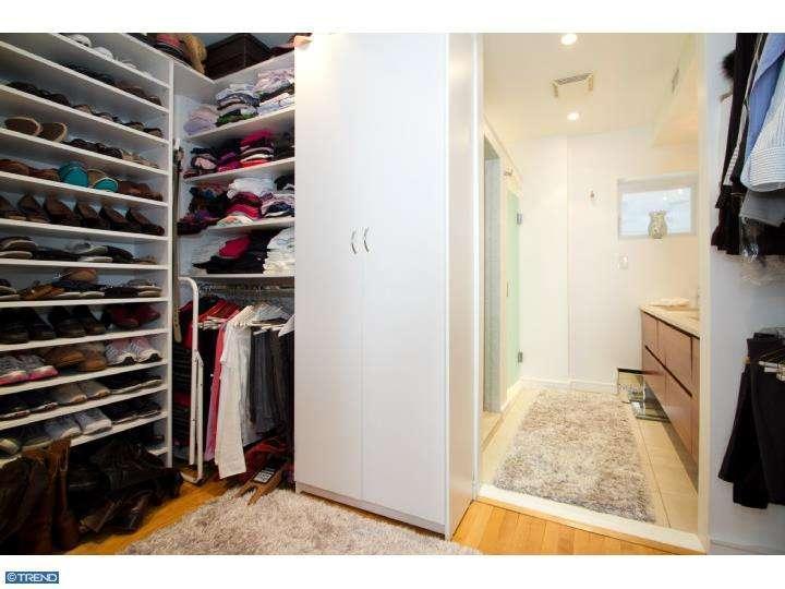

I won't go through the painful process, but we eventually had a stroke of inspiration and remembered that we can actually walk through the walk-in closet to get to the bathroom.
I know this sounds very weird, but it's not a new idea. Some examples:
Our designer mentioned that he had never done this before, but would be open to doing it if we wanted. He said that his main concern was with humidity. Since the bathroom door opens into the walk in closet which has no window, there is a higher chance of mold growing. Luckily our shower position was all the way at the back of the bathroom, so he suggested two things:

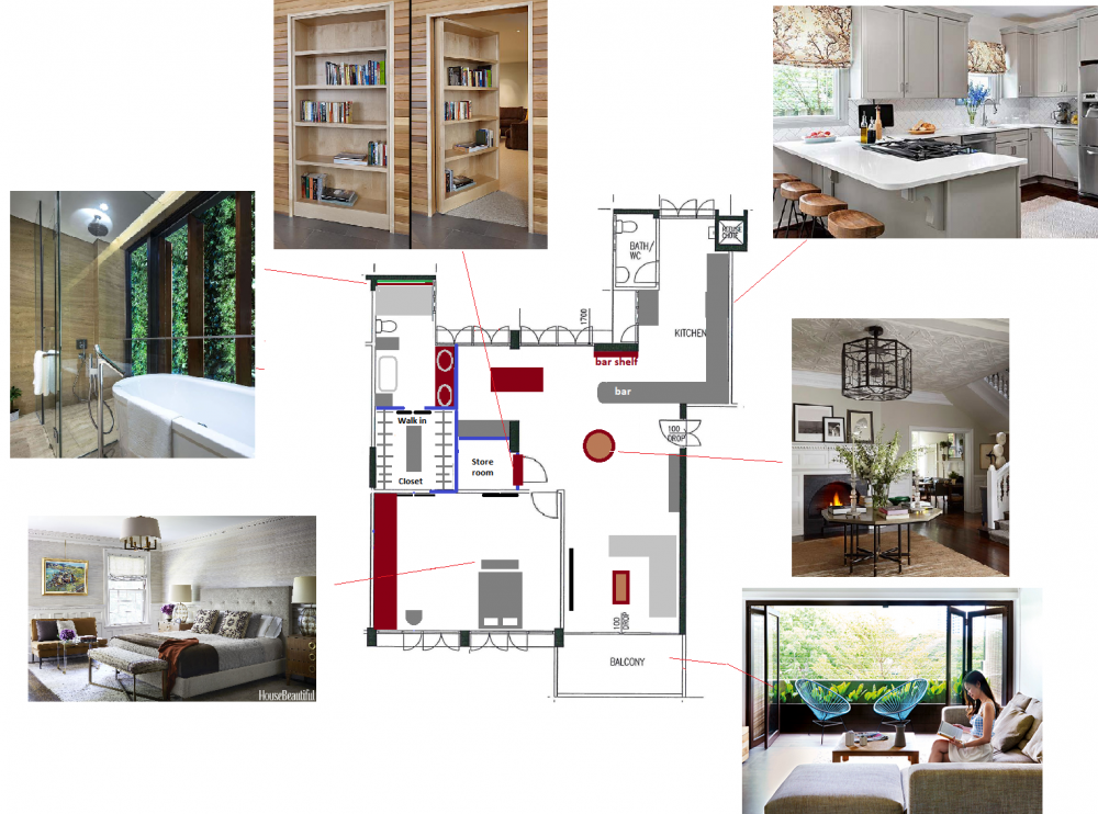

Here's my own diagram of what it should look like, along with some pictures as examples!

So our designer called us back after checking on the options to cover up one window pane with a wall. Basically, he said that with HDB restrictions, the only way to do it would be to do a proper wall all the way until near the window, then for the last 30cm or so do a box-up, and cover the window pane with a painted wooden board. So in the picture below, blue is actual wall, red is box up, brown is wooden board:
This has a few serious issues:
1. box-up in that area will not last, because sink area keeps getting wet. So it will create a lot of problems down the road.
2. Because we cannot touch the windows, the remaining open window in the bathroom will look ugly and not symmetrical.
3. Because this involves sealing up only half the window pane, the seal is not airtight. So if someone is doing their business inside, someone outside in the living room may potentially be able to smell or hear.
