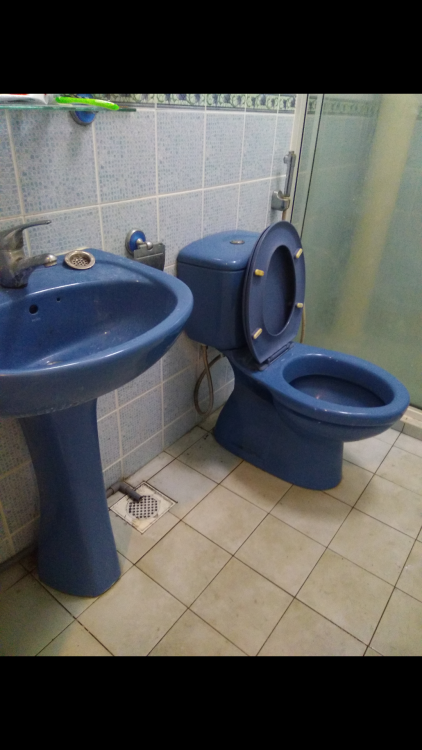

Of course, these disgusting toilets had to go first! The tenants have trashed them up so badly, they are worse than public toilets! Sorry if I spoilt your appetite for a meal! I nearly threw up when I came to inspect the premises!?

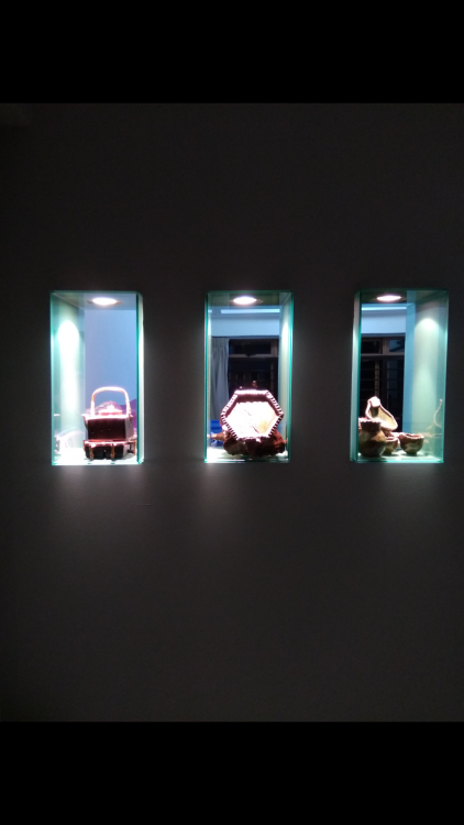

These are old pictures of my initial reno 16 years ago. We did our place in resort style. Some call it modern Asian style!

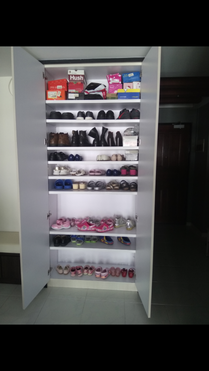

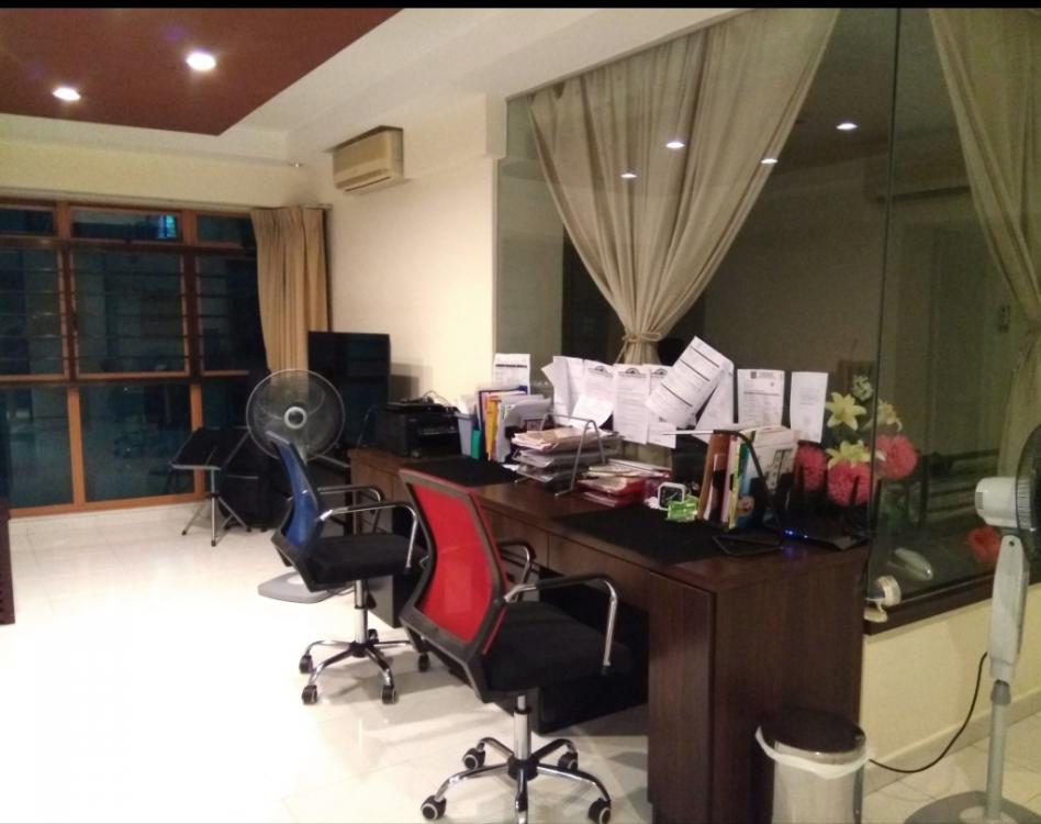

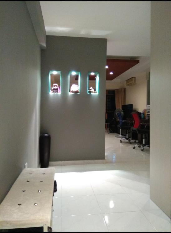

Years later, we took out the pond (what were we thinking??) to build a full-height shoe cabinet, & detached the built-in study table into a mobile desk which we placed @ the living room.  The study room was transformed into a bedroom, and the build-in master bed with side table, headboard, and display shelves were ripped out, as well as the shelvings in all the bedrooms. We built three new cabinets in the new Scandinavian style -not sure if we successfully married the old and the new style, but we sure didn't want the hassle and added cost of tearing out everything from before, especially when they were in good condition! To change the laminate color was not a simple matter of putting new laminate over the doors like I previously thought. It actually involves ripping out the doors, and installing brand-new doors! Well, I still like the dark wood colors! And of course I didn't want to spend the extra moolah!
Here are pictures of my recent reno. It is still a work-in-progress, though it's mainly just some minor nitty-gritty to be touched up, plus more shelving for my shoe cabinet cos we can never have too much space! i have not decided what to do with the bomb shelter hole, now that I took out the bamboo chick blinds. The pics are taken by me who's no photography buff so no fancy touches or ambient lighting like the old pics! Of course style is also very personal. We did a simple reno this time round, but I'm sure you can ask Yeo for snazzier designs! I'm still contemplating building another full-height cabinet where the bomb shelter hole is to put the whole wall to good use but that entails taking out the bench. It's a tough call, ripping out stuff you built, like, and which are perfectly usable, but I could do with an additional cabinet to hide bedsheets or toys as our storage beds are full! 3 kids sure have a lot of toys and clutter! ?

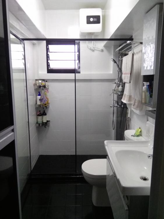

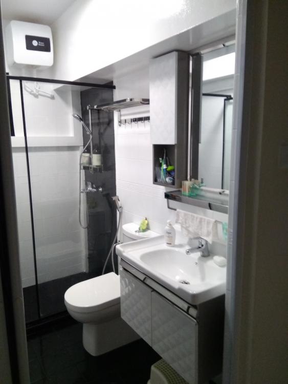

And as promised, here are pictures of the completed revamped bathrooms! Ta-da! 180 degree change from before right?
  • Thanks 2

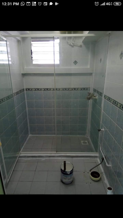

Ok so here are some pics as promised!

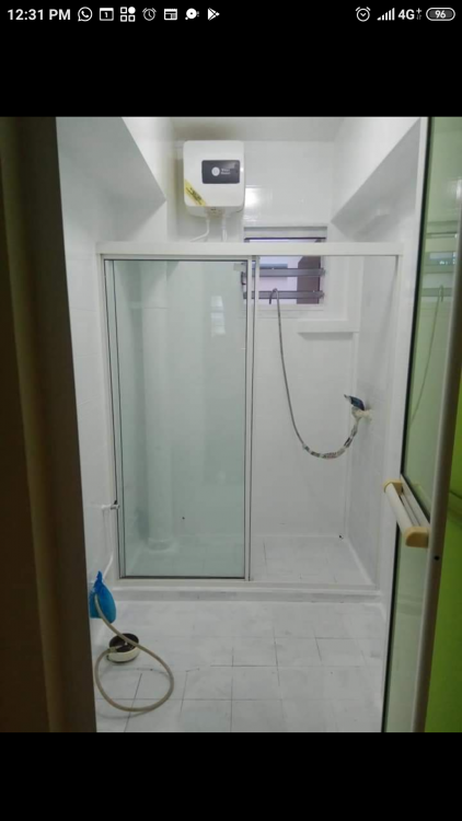

Here's the bathroom with its original blue tiles! Screenshot_2019-05-17-12-31-15-323_com.facebook.katana.png.295aae5ee0ce9759728b4c02f5c7fd56.png

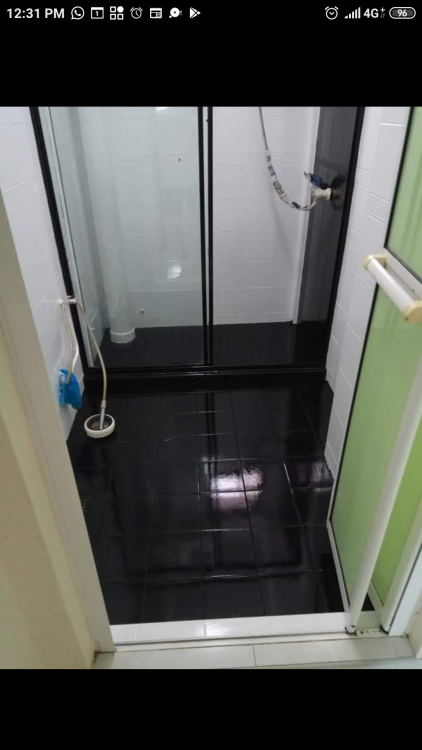

Screenshot_2019-05-17-12-31-25-319_com.facebook.katana.png.894dd5e4f5e69f8cc49fd8d60322c1e7.png

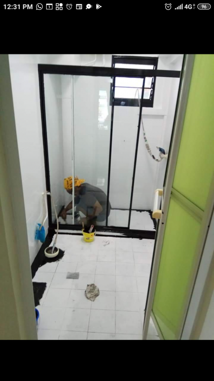

Got my floors a coat of black to glam it up!
Screenshot_2019-05-17-12-31-29-131_com.facebook.katana.png.067e7d16a9aa1781690c063d3b18eb5c.png
And finally...
New doors
New WC
New wash basin c/w stainless steel cabinet, mirror, shelf & side cabinet
New shower set
New stainless steel shelves
New stainless steel towel racks
New 3-way ceiling light
New toilet roll holder
New bidet
So basically the only stuff we kept were our stainless steel water heater and our glass shower frame!
