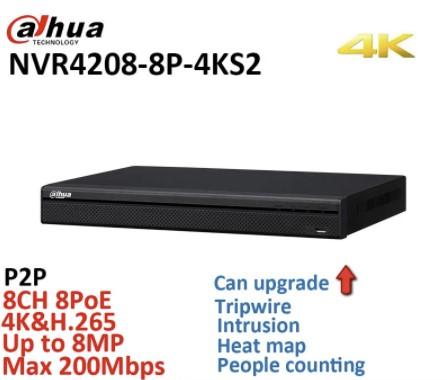

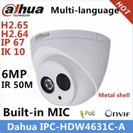

Any need to have fixed domain for remote live view?
Are these the cameras and DVR you bought?
no need for any fixed domain/IP for the remove live view. I think the NVR sends it's public IP periodically to the dahua servers such that they keep a record of the NVR's current address and hence you can use the app to connect remotely. You will need to allow some ports to be open on your router/firewall though. Always set a strong password for the NVR such that they can't be accessed by anyone else using the default password.
i bought those cameras with glass domes. felt that they look slightly better than the one you found. my NVR is only up to 6MP since my cameras are 6MP. just make sure that the NVR has more than enough POE ports for the number of cameras you need

Do your cameras have upgradeable English (Global) firmware? I noticed that some of the Dahua cameras are actually meant for use only in China but Aliexpress sellers install a "hacked" English version of the firmware to sell overseas. They explicitly say that the firmware cannot be upgraded.
If you have managed switch with POE+ in your network, just buy the NVR without POE. This will save some cost. With all cameras connect to the switch, you can route the signal to a lan port (which also connected to the switch) in turn connected to the NVR to view all camera view.
The Dahua NVR software UI is in English. I bought my full CCTV system locally where most contractors also buy to install for customers. Their price is also much cheaper from what you can find in Shopee or Lazada. PM for contact sharing. Warranty is covered for 1 year. There are many types of camera specs. From experience, night operation is more important than day. Any 4MP and above day operation is very clear already. The challenge is night operations. Full night color or IR kicks in under a certain LUX threshold. One has to decide carefully else night capture image will be blur.

didn't bother with the firmware. i go with the belief that "if it ain't broke, don't fix it!"
so i just use what's out of the box
