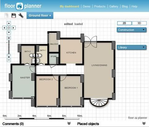

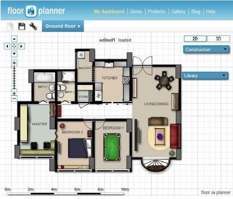

My house also not big lah, master room so small. That's why gonna hack a small opening through 1 room to combine 2 rooms. Just did this overnight. Do until 7am ah!
Original
edited
So limited space. Arghh. The green colour thingy in the master room should be the office table, the yellow being the wardrobe. Hope you all understand what I drew.
Oh the pool table is a joke. Just ignore it. =D

Based on your floorplan.. I think u need 2 fancoil, cos if the opening is just 1 doorway, then the cool air may not spread evenly. The room with the fancoil will be cold, while it will take time for the other room to cool down.
Dun mind me saying... I think the original master door shd retain, and seal up the door next to the bed. Reasoning is that whenever come home.. first thing to do is to change to home clothes or use the toilet. If the door is from the bed, then got long way to walk. Better to have direct access.
Also.. shd consider hack off the whole wall between the 2 rooms.. then got the really grand open feeling.
Do you mean 2 fancoil as in 2 aircon units? Sorry I did a google but I still dont quite understand about the fan coil thingy..
Ya If 1 unit, even if in between the 2 rooms, doubt it will really cool both units. Even with the curtains thingy, the aircon need to be placed perpendicular to the 2 rooms which are side by side..and even so, I doubt the aircon air can go freely.
I chose to have the other door at the bedroom 2 is because I think it's more welcoming to come home and see a nice spread of bed. =) On the contrary, if the first sight that greets the MBR is the toilet and wardrobe, I will feel abit sian. But of course both have their pros, your idea is more practical with more privacy.
Hack off whole wall between 2 rooms ah, hmm will definitely look more spacious. But where to mount my TV? Hmm unless set up a mini featured wall to mount it? As you can see, we're trying desperately to squeeze in some office desk...will it look weird if no wall to separate the 2 vastly different rooms which serves different purposes but yet a need to combine them together? A bigger curtain for partition?
