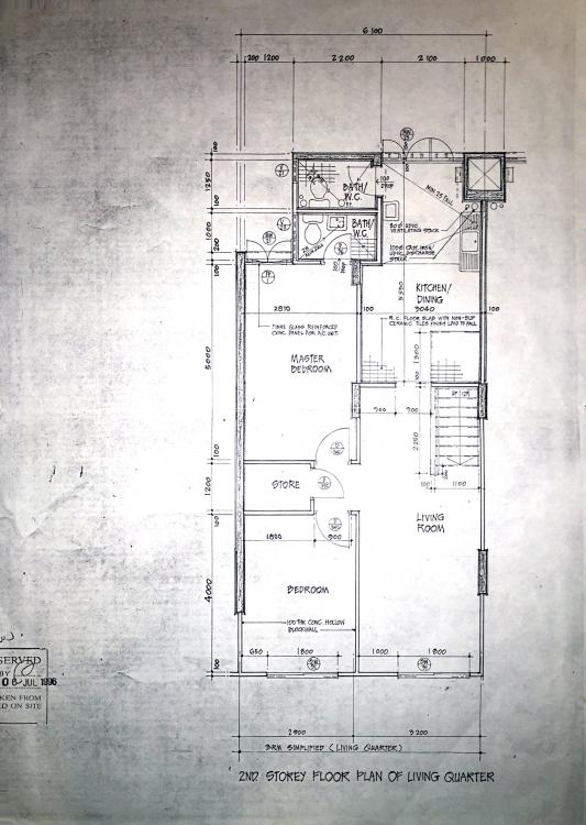

First, the floorplan as usual. Pardon me for the lack of clarify in my floorplan as it is an old handwritten floorplan.

As this living quarter is a 3-room flat in a double storey HDB shophouse, there is an internal staircase inside the flat. Other than the staircase, everything else is the same as a typical 3-room flat. It has a floor area of 77 sqm. It has a big master bedroom with a good size bathroom and a big living room. But the kitchen and dining area is limited by the staircase.
This project involves the alteration of the flat by removing the internal staircase and creating a new entrance to the 3-room flat as highlighted in RED in the picture below.

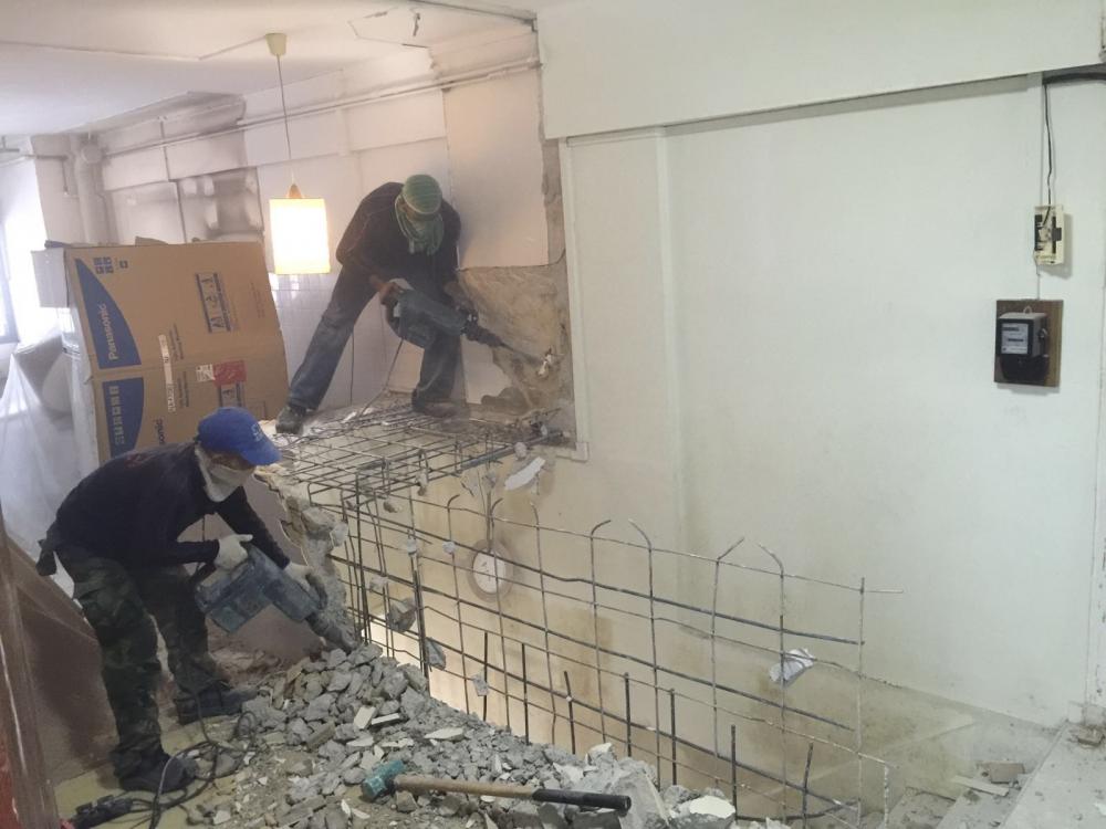

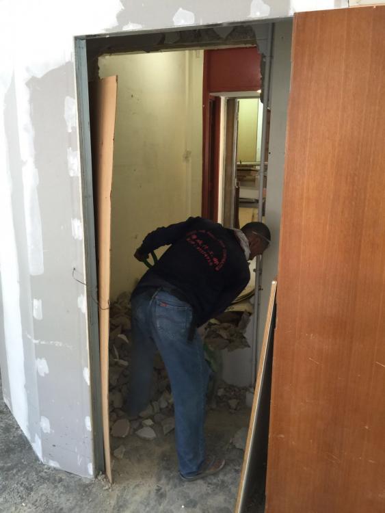

As mentioned, this project is not a typical renovation with an ID or a contractor alone to work on the inside of your flat, it involves the creation of a new entrance to the flat as shown in the picture below. Notice that the back of the existing storeroom in the 3-room flat will be hacked to the outside in order to create a new entrance. With the new entrance to the flat, the internal staircase can be demolished as well.

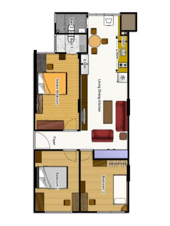

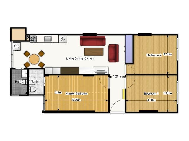

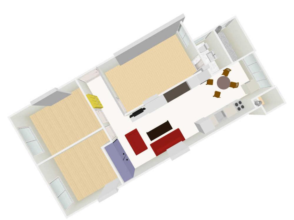

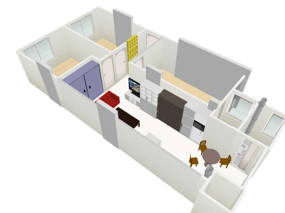

As you can see from my new layout plan above and below (turned right 90o), the original master bedroom and bedroom 2 remain as it is. In the new layout plan, I shall add a new bedroom 3 which is used to be a part of the living room. The smaller living room, dining room and kitchen will all be integrated into an open concept layout. The new entrance, which will be created from the old storeroom, will bring in some light and wind from the outside (which is a lift landing area).
The new bedroom 3 is as big as the original bedroom 2. More importantly, it has big windows to make it very livable for the occupant. In order to provide storage area, a portion of the new bedroom 3 is carved out to make way for a large floor-to-ceiling built-in storage cabinet.
Edited by KFC1189

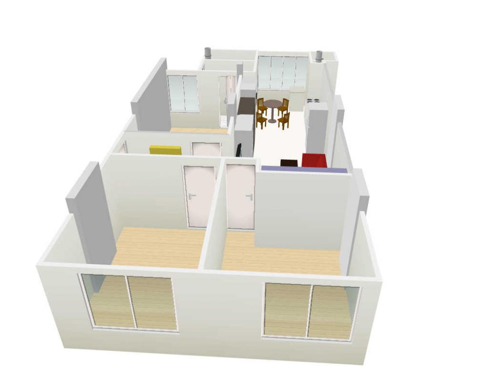

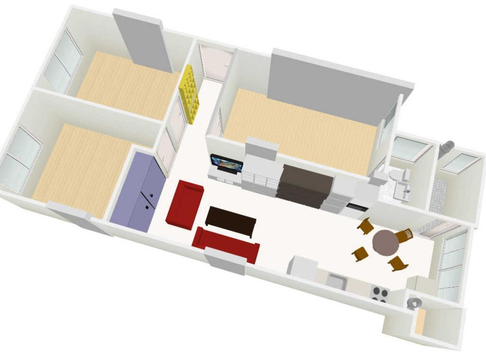

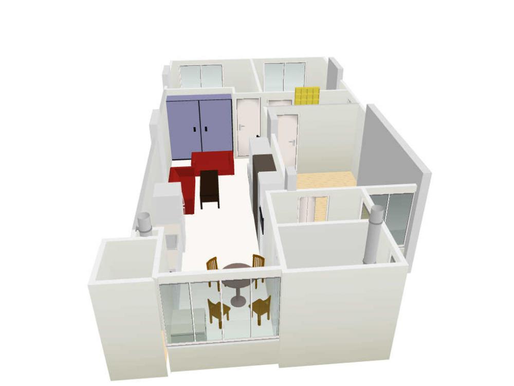

I used Floorplanner to draw my floor plan. It can also generate 3D plans as shown below. Obviously, the windows in my 3-room flat are not so high.

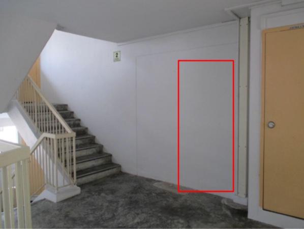

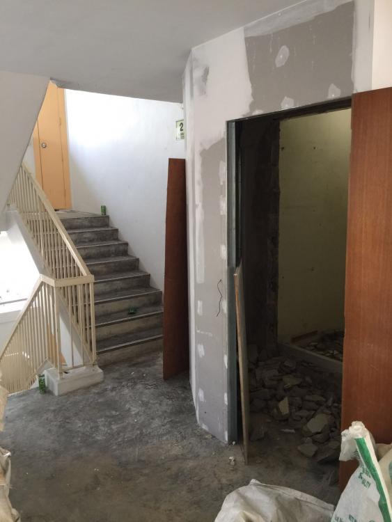

Proposed new entrance door opening. The proposed location of door opening has been verified by a registered PE and approved by HDB.
Edited by KFC1189
Now a new entrance to my 3-room flat has been created! Yay!
With the new entrance, I lost my storeroom but gained a new bedroom. In order to provide an alternative storage space, a new W2300xD600xH2000mm storage cabinet was created at the wall of the new bedroom. Please refer to the 3D drawings above.

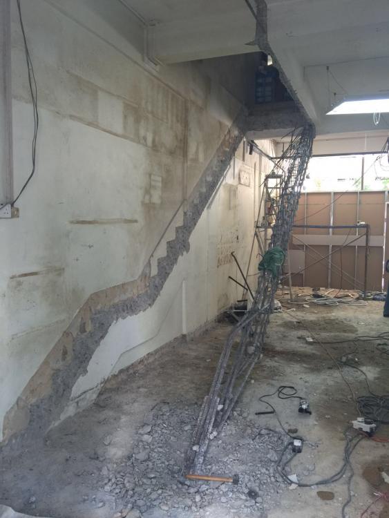

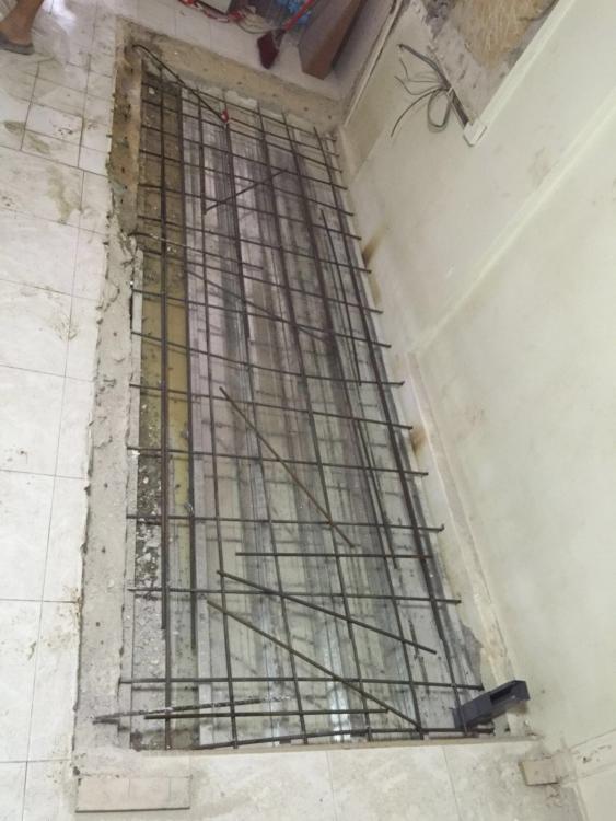

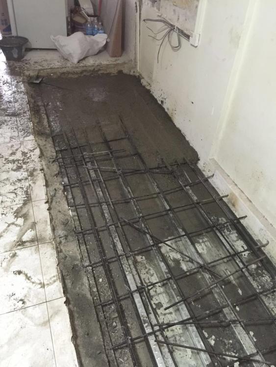

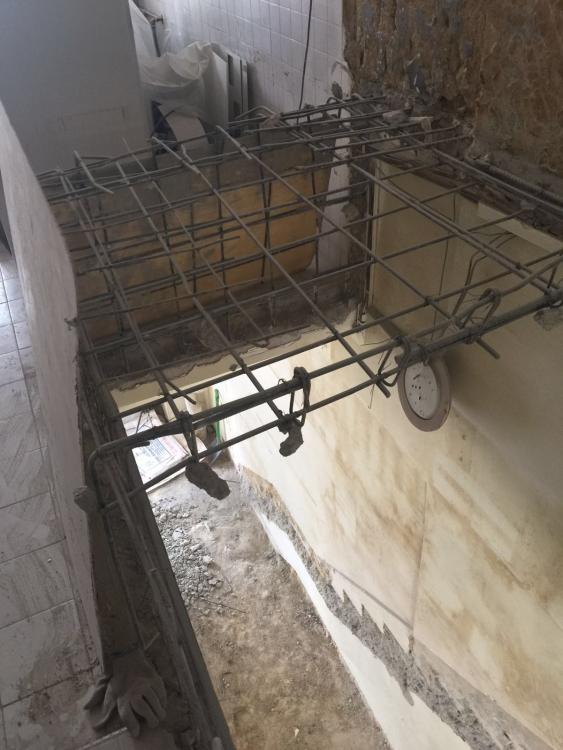

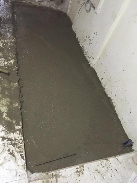

It has been a long time since my last update. After the new entrance door at 2nd level was created, the internal staircase was demolished. After that, the staircase hole would be slabbed over and be leveled with kitchen floor. Eventually this newly created space will be part of living room. The living room, dining room and kitchen (LDK) will be combined to form an open concept layout.
Edited by KFC1189
Metal plates and reinforcement bars were installed for the floor slab work. Then cement was used to fill the void area.
Edited by KFC1189
