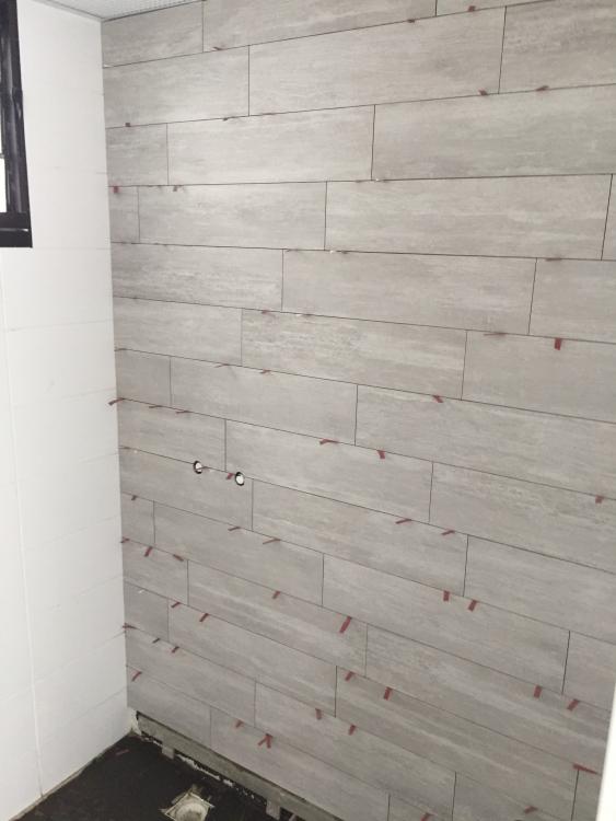

Week 3 to week 4
Tiling & wet work will commence and complete this week.
E advise us to ask our Aircon contractor to drill the hole for the trunking in our master toilet first before he proceed to do tiling work. Reason being if the aircon contractor were to drill the hole after tiling is completed, the vibration from the drilling might affect the tiles. So quickly call aircon contractor to arrange date for drilling otherwise cannot commence tiling.

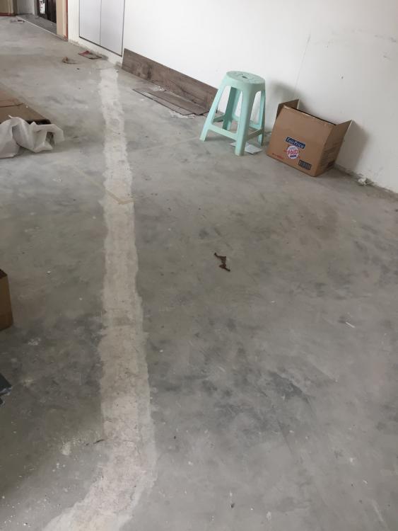

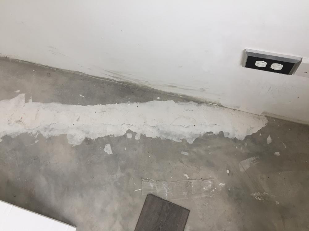

1st hiccup of our journey

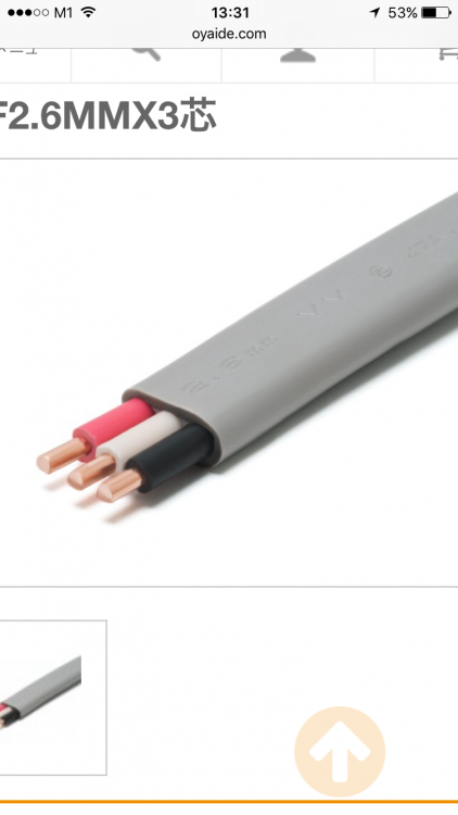

As I have mention earlier in my post, I will be having a dedicated power line direct from the MCB to bedroom 3 for my audio system, therefore will need to pull a cable from DB box to bedroom 3. By right I should have lay the cable first before we do cement screed so the cable can be buried underneath the cement. Since the cement screed has long been completed, E told me the only option is to hack a channel on the cement to lay the cable and patch up the channel :~
Order this cable from japan. 20m of solid core wire, stiff and thick... think my electrician must have a hard time bending and installing the cable :P

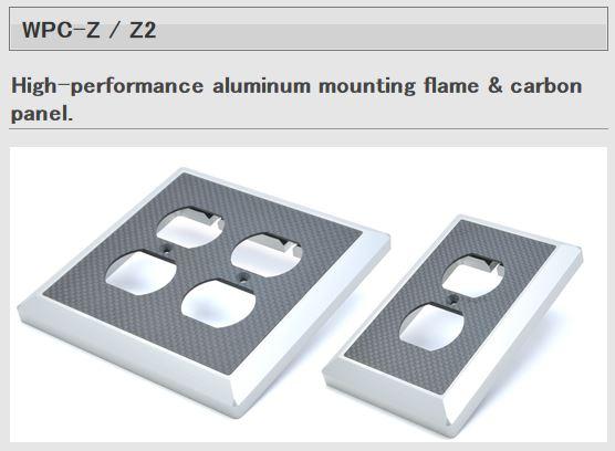

Order this aluminum wall plate and receptacle from japan as well.

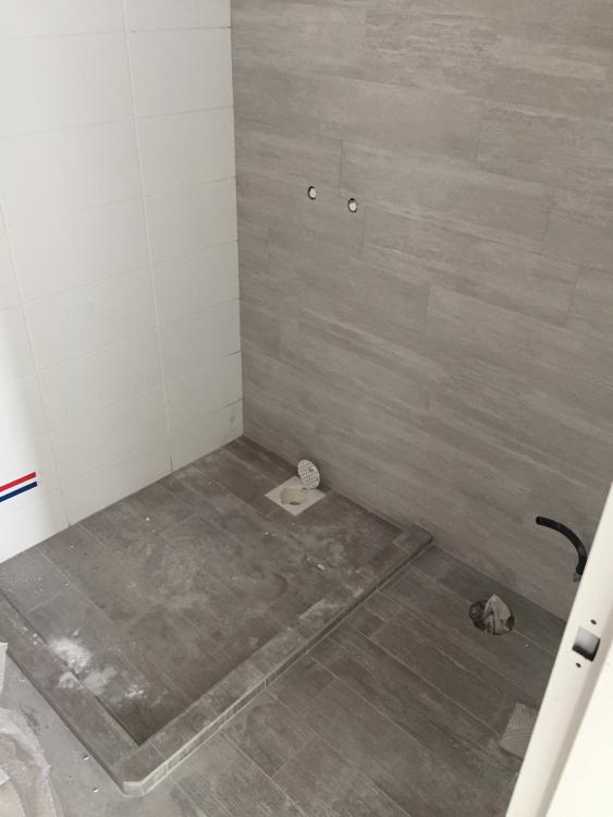

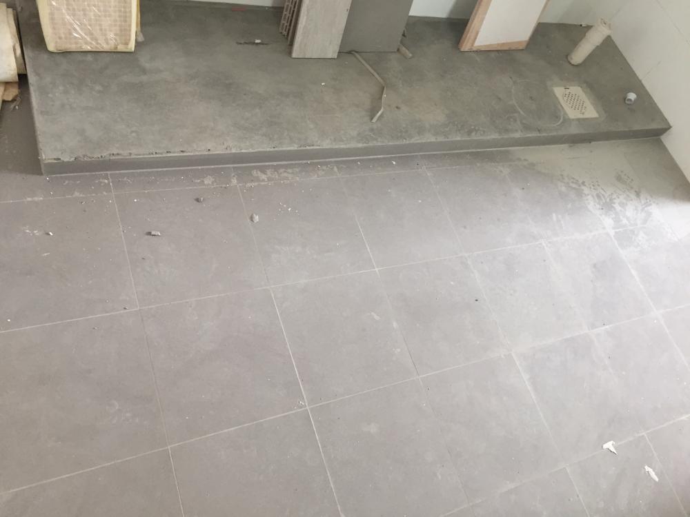

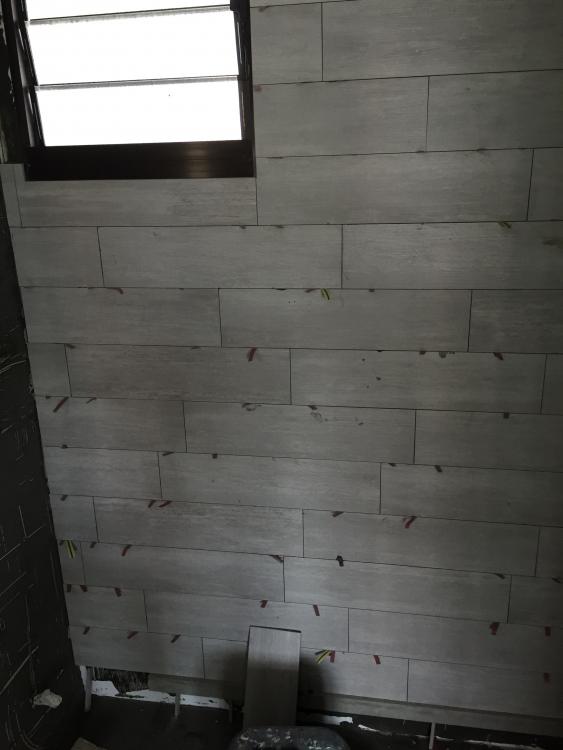

Tiling & shower kerb completed
Common toilet
Master Toilet

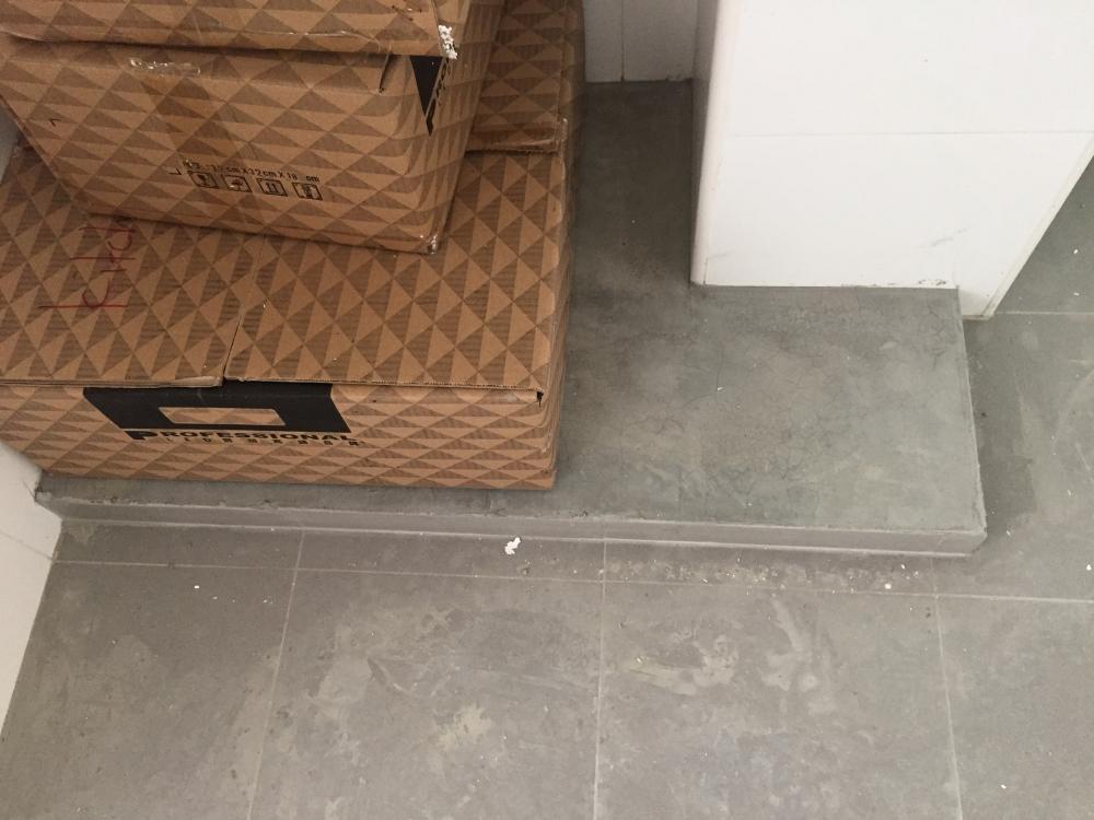

Left over floor tiles for toilet use to construct main door entrance. Decided to do step up instead of slope.

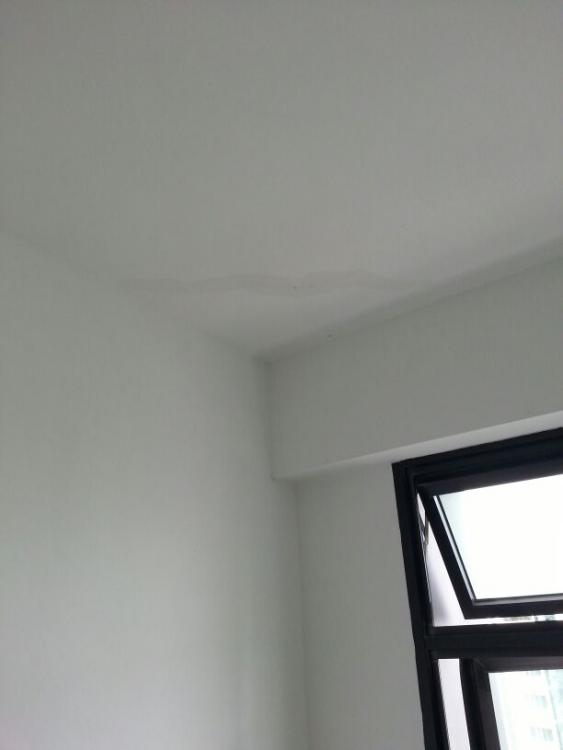

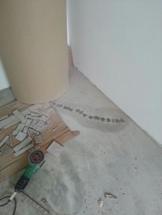

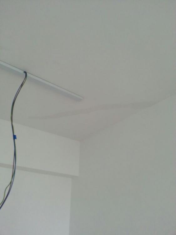

2nd hiccup of the journey
During the period when tiling work were in progress, one fine day E send us these pictures.
Are you thinking what I am thinking...
Yes, ceiling water leakage at the master room. One near the window and one near toilet.
Upon seeing these pictures, wife being the more "kan cheong" type, while I am the more relax type (that's y we are together, kan cheong + relax = just nice Lol) immediately took time off from work and rush over to our place. Found out that our unit above were doing cement screed, causing ceiling to leak water. Does new bto do water proofing for the whole unit or only the toilet??? :huh:
Anyway wife went over to BCS to complaint and the next day they sent their contractor to rectify the issue. We do not know what they did as we are not around to see when they came to rectify the issue but according to our tiler, they just put some compound over the affected area and repaint... Hopefully this issue were resolved. Finger crossed!

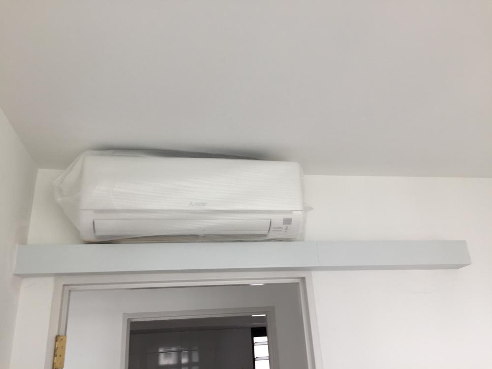

Aircon & L-box installation
We arrange for the aircon to be installed after the tiling work were completed cos E told us he will arrange for the L-box to be install soon.
Before we confirm our order with our aircon contractor, we went around asking for quote, comparing different model of aircon and the type of material they use for the installation.
I had bad experience with the aircon installation for my parent's house. They were using ME inverter starmex system and has been giving alot of problems with condensation and water leakage. Before that I was a noob and always though that it's the system problem. After talking to some aircon contractors and doing some research in the forum, realize that all these issues were mainly caused by using inferior parts and poor installation.
I get to know this aircon contractor through recommendation from some of the t-bloggers here.
Basically I think his pricing is pretty competitive and also he is able to provide me with good advise on the type of material and the required btu to use. Most importantly what I heard from fellow t-bloggers is that their workmanship is pretty good.
ME Starmex Inverter Sys 4
1 x Mitsubishi Air Con Compressor 28,000 btu ( Model: MXY-4A28VA)
3 x Mitsubishi Air Con units 9,000 btu (Model :MSY-GE10VA ) for 3 bedrooms
1 x Mitsubishi Air Con units 18,000 btu (Model :MSY-GE18VA ) for living room
Material
0.5 inch CLASS "0" ARMAFLEX Insulation
Grade SWG 22 (0.71mm) copper piping
16mm drainage pipe with insulation
Singapore made premium grade control wire (Keystone)
Free site survey
2 times installation

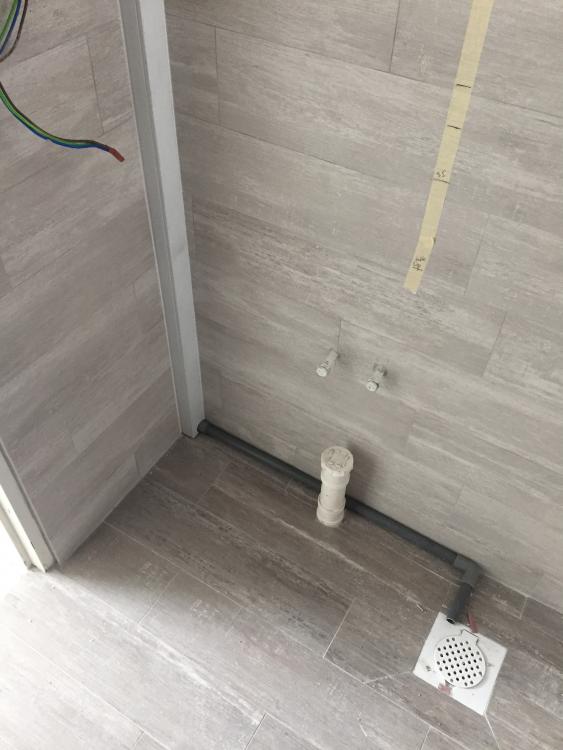

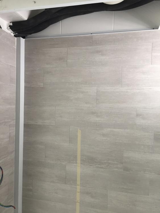

Piping & drainage pipe at master toilet

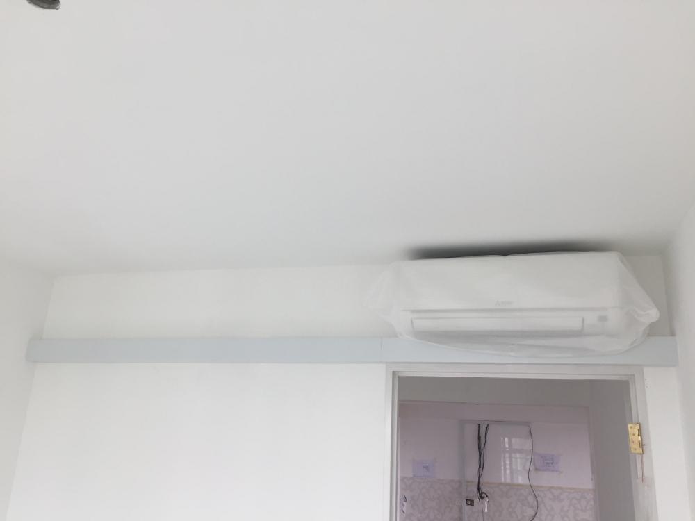

Master room with L-box & trunking boxed-up
Common room 2
Common room 3

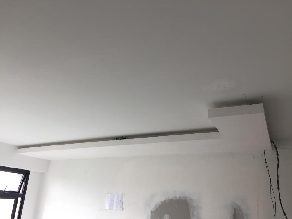

Living room
During the site survey, have a discussion with the installer and decided to run the trunking this way to minimise being seen.
L-Box Living room

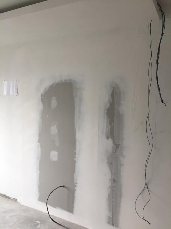

Uneven wall boxed-up living room

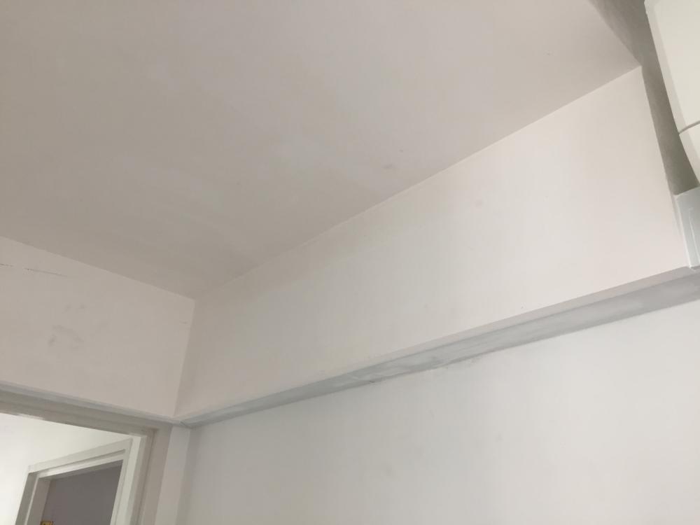

Uneven wall boxed-up master room

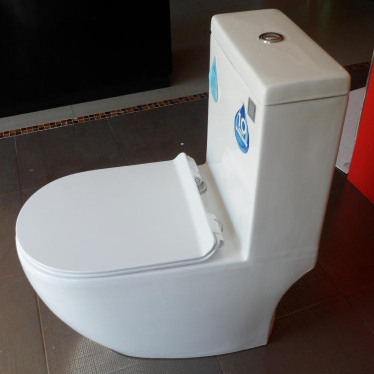

Baron W888

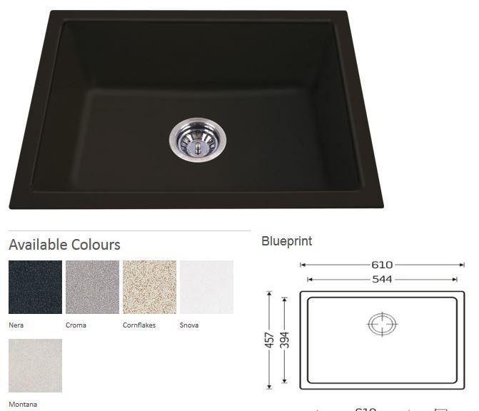

Carysil big bowl in nera

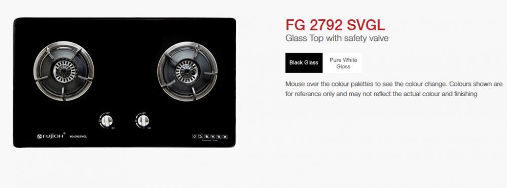

Fujioh FG2792 SVGL Hob

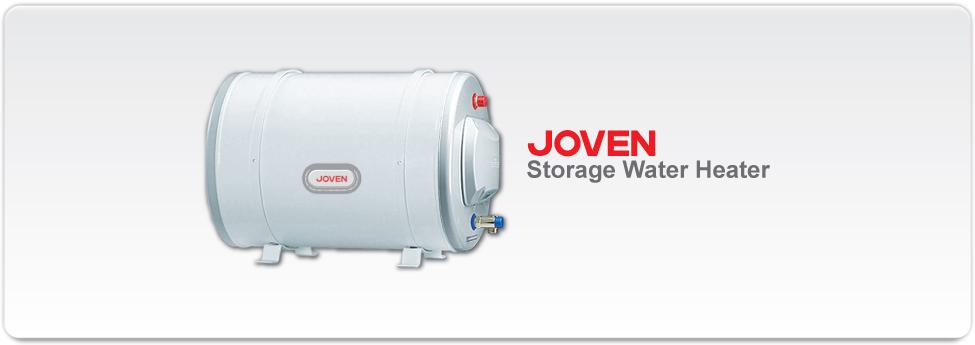

Joven 25L storage heater

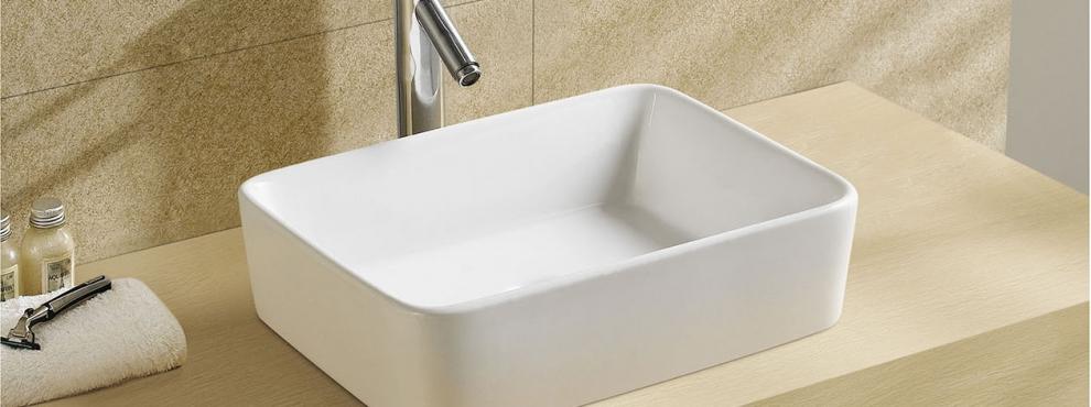

Master toilet square basin

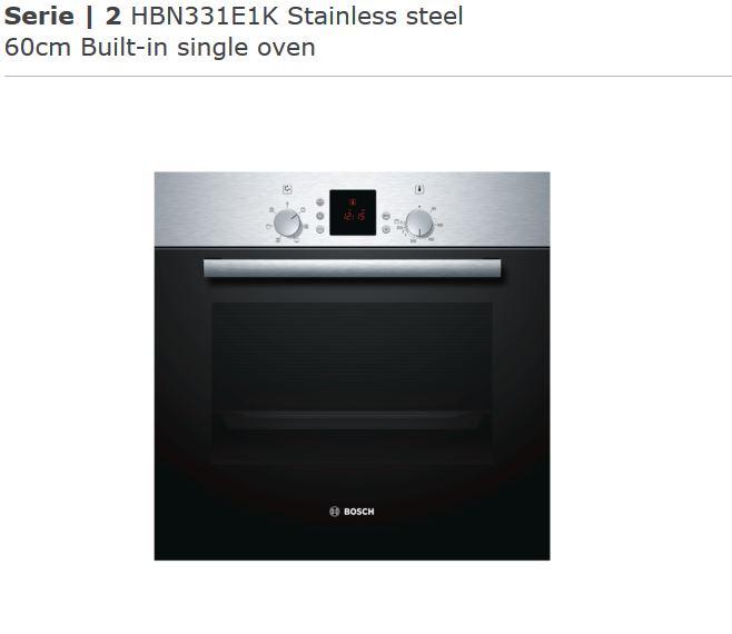

Bosch Build-in oven

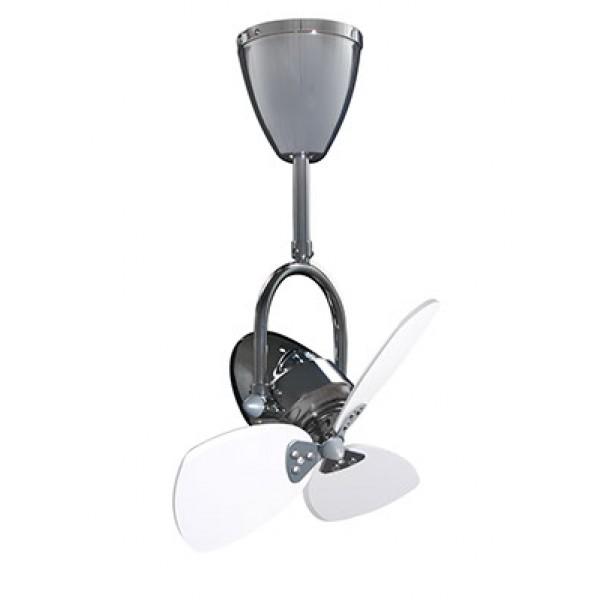

Master room fan - White vento fino
